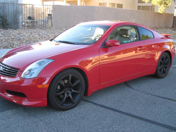

maintenance tips?
Hello just purchased.. 71k miles flawless condition.. anyone had tips for the vehicle id much appreciate it.. the last owner used conventional oil, I personally like synthetic. Will there be an issue going from conventional to synthetic oil? What brand and weight oil do you recommend (las Vegas)? Oil filter? Any recalls? Anything I should be careful about? How's your g35 been treating you? How often to change tranny oil? Anything would help... thanks
