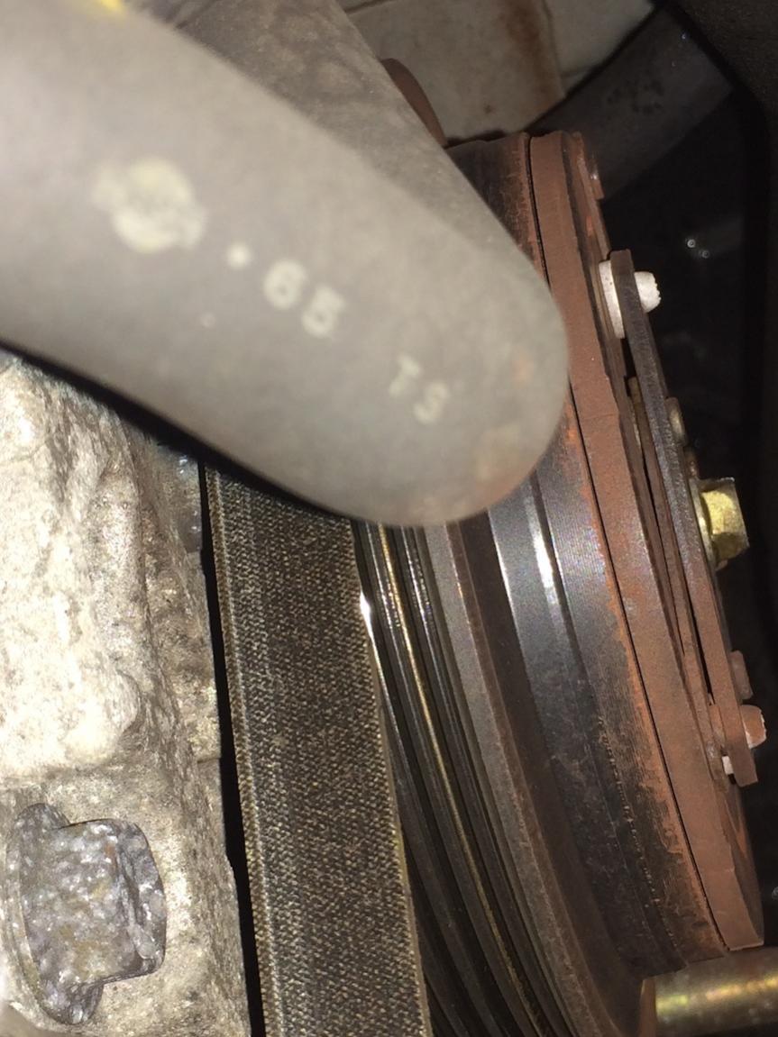

Ok I think I found out what the problem is. I went out side today to see if I can tell exactly where the noise was coming from.
The more I listened the more I sounded like it was coming from the bottom right side of the front of the engine. The sound wasn't coming from the engine itself.
So I looked at the belts and the pulley and noticed that the one belt was shifted on I guess would be the tensioner you can see in the picture I posted. My belts are pretty bad as you can tell and I've never had them changed.
Also on the bottle right which I assume is the air conditioner you can see the belt has shifted and isn't aligned on the pulley.
I'm going to take the car in this week and get the belts replaced.

Good looking out, that definitely needs to be fixed.

Have Nissan replace the belts, less $$ than Infiniti!
Seriously good news...^...had you gone to the Stealership they would have sold you a new engine! Now that your wife has her own car you can take better care of your G35.

Id be eagerly trying to replace that belt myself to see if thats the noise or not. Pretty big deal.
