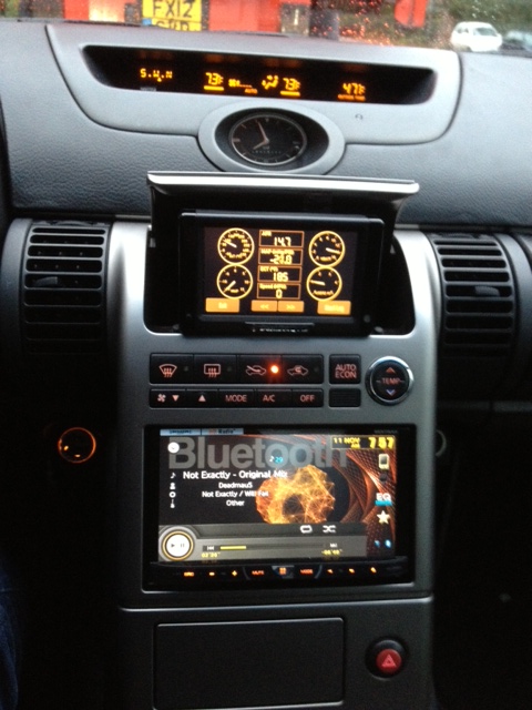

Thanks for the help. I've attached a pic of my set-up to monitor my vehicle. I've been meaning to post pics to give other members ideas as to how they can use a digital system as opposed to a the traditional gauge pod set-ups. I'll get to that later though. As you can see in the pic, I'm monitoring 8 different readings on my Dashdaq screen. 4 look analog and the other 4 are numerical in the middle of the screen. The ECT temp is the third one down. I do throw a check engine code for low coolant temp as well, despite the reading on my speedo eventually getting close to the middle. The ECT temp reading is coming directly from the OBDII so I can't see how its off really, Seems weird to me. Just trying to figure out if the thermostat is the culprit here. From the numbers its seems that my temp is pretty low, which may be the cause for me bad gas mileage. Let me know your thoughts.

Just to add, when I took this pic I wasn't moving. The engine does heat up when in stop in go traffic. It was at 185 in this pic. Cruising speeds on the highway keep it at 154 though.

Here is larger pic.
