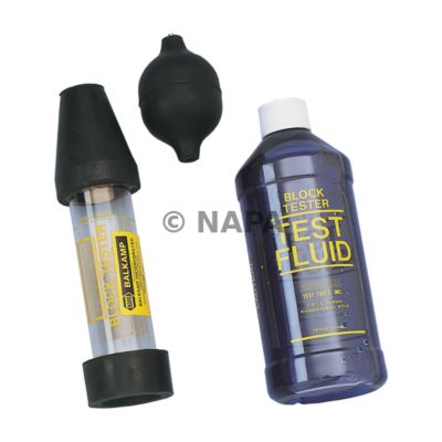

Update..
i purchased an engine block test (see pic) & did the test. bought at NAPA for about $30 - $40.
i couldn't find the drain plug from radiator (aftermarket one replaced 4 yrs ago). so i remove the upper hose to the radiator to release some coolant from radiator to do the test. i did the test & tested negative meaning no bad head gasket but while testing, i did about 2-3 times at 1 min but the coolant keep on coming up from radiator when doing test. i let engine cool down. remove upper hose again but this time not much coolant came out. did the test, this time was able to do test longer, about 4 times at 1-2 min. & test came back negative. i stopped because coolant was coming up again from radiator.
i decided to take it over to my friend shop & see what the issue is since i also have an oil leak. Think the oil leak is common as it is by the spark plug, valve cover o ring leaking.
Attached Thumbnails 03 G35 Sedan:  Overheating... Coolant Level is Fine, Reservoir Full-block-test.jpg
