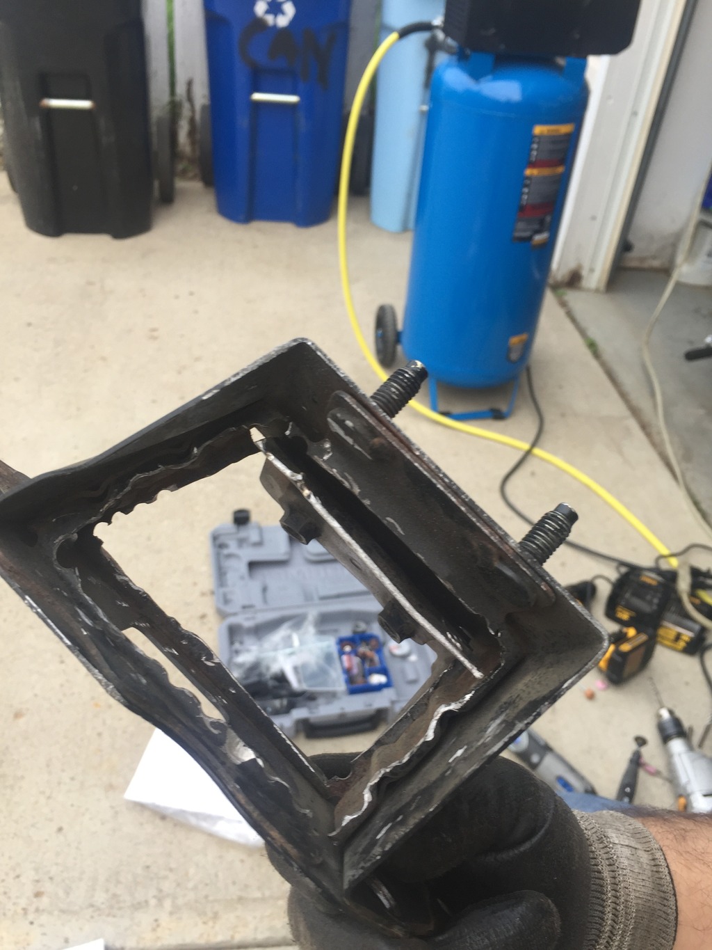

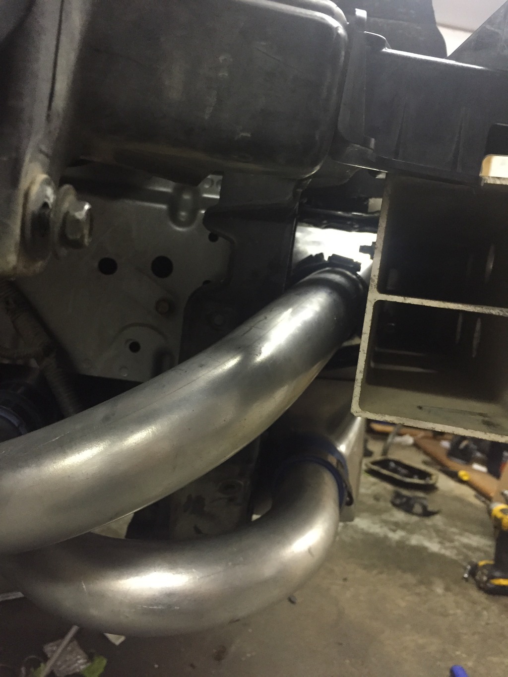

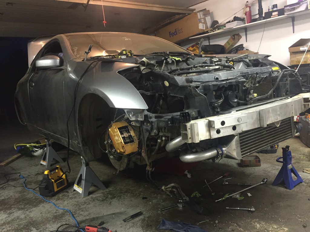

Daaamnnn you Greddy for not mentioning you cant install the crash bar when mounting the intercooler in their kit. I dont know what idiot would even think about running without a crash bar.
For anyone who is interested in running the Greddy TT kits you have to either delete the crash bar, or find a way around it. If you wanna run the crash bar (and you should) you can gut the factory bracket and get the pipe through. It wont be as solid as original design but definitely beats not having one at all. Shittty phone pics, but gives you an idea.

Tons of people remove it.
You can replace the aluminum one with a steel bar.
http://www.enjukuracing.com/products...ssan-350z.html
GIve more protection and more room. They are easily fabbed by any decent welder for <$100.
