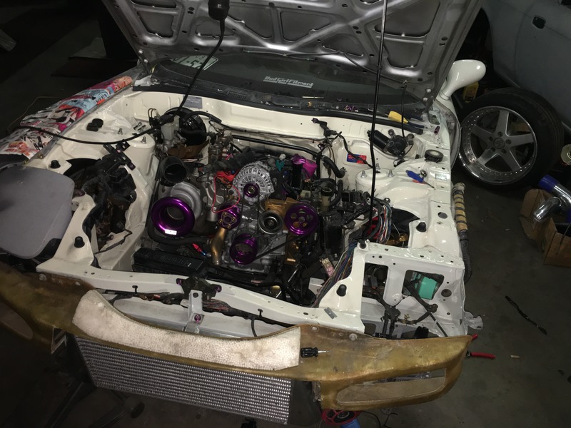

Got some progress done , not as much as I had hoped because I had jumped over to my other project rx7 that's almost done and finally got that fired up, I'll tell ya two plus projects at the same time is a bit draining lol.
Here's the rx7 as I am chasing wires

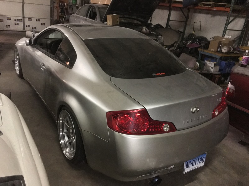

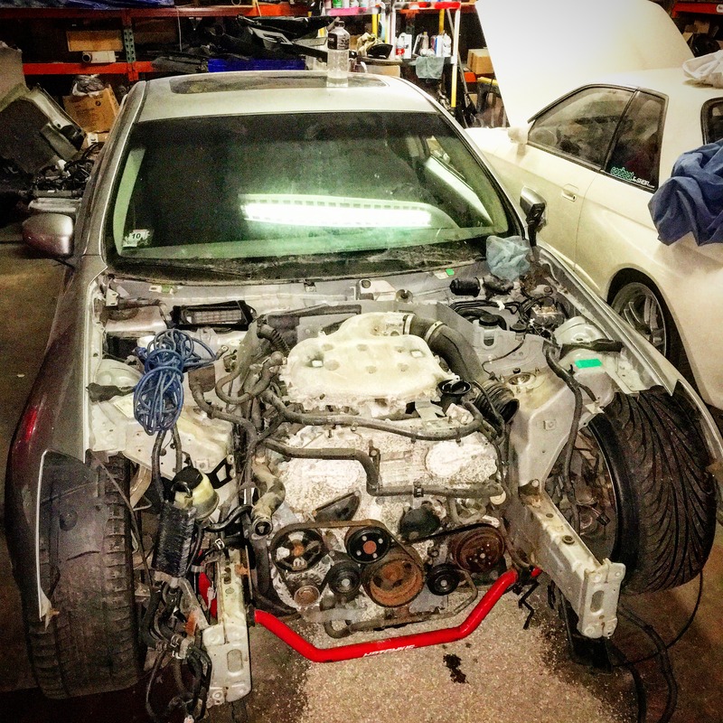

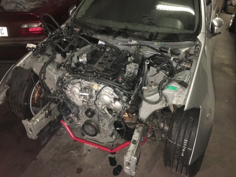

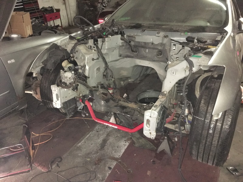

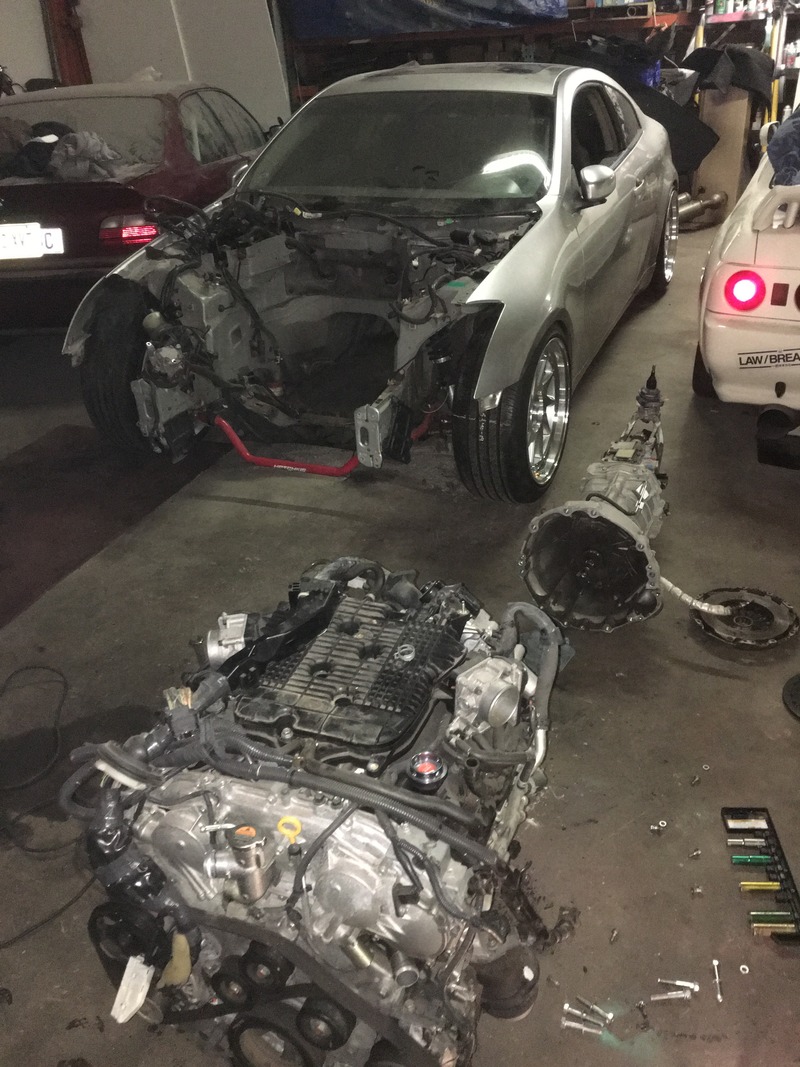

Finally some progress! Spent the last few days pulling engine , cleaning prepping vq37 , measuring where everything should sit ect . Installed 07 350. (Hr) rack, 07 350z motor mount brackets and original vq35de mounts. Test fits and she fits like a glove. As of now I'm waiting on my long tube headers, lw flywheel and a few other odds and ends . Next will be drive shaft and have the harness done, I've been saving my pennies and I'm bout halfway saved up the 2400 needed for the harness I'm going that route as its plug and play and eliminates any headaches or worrys and its all immobilized .
Picked up some new cheapie wheels to play on, this car will be drifted all this season, no use running 4K wheels
