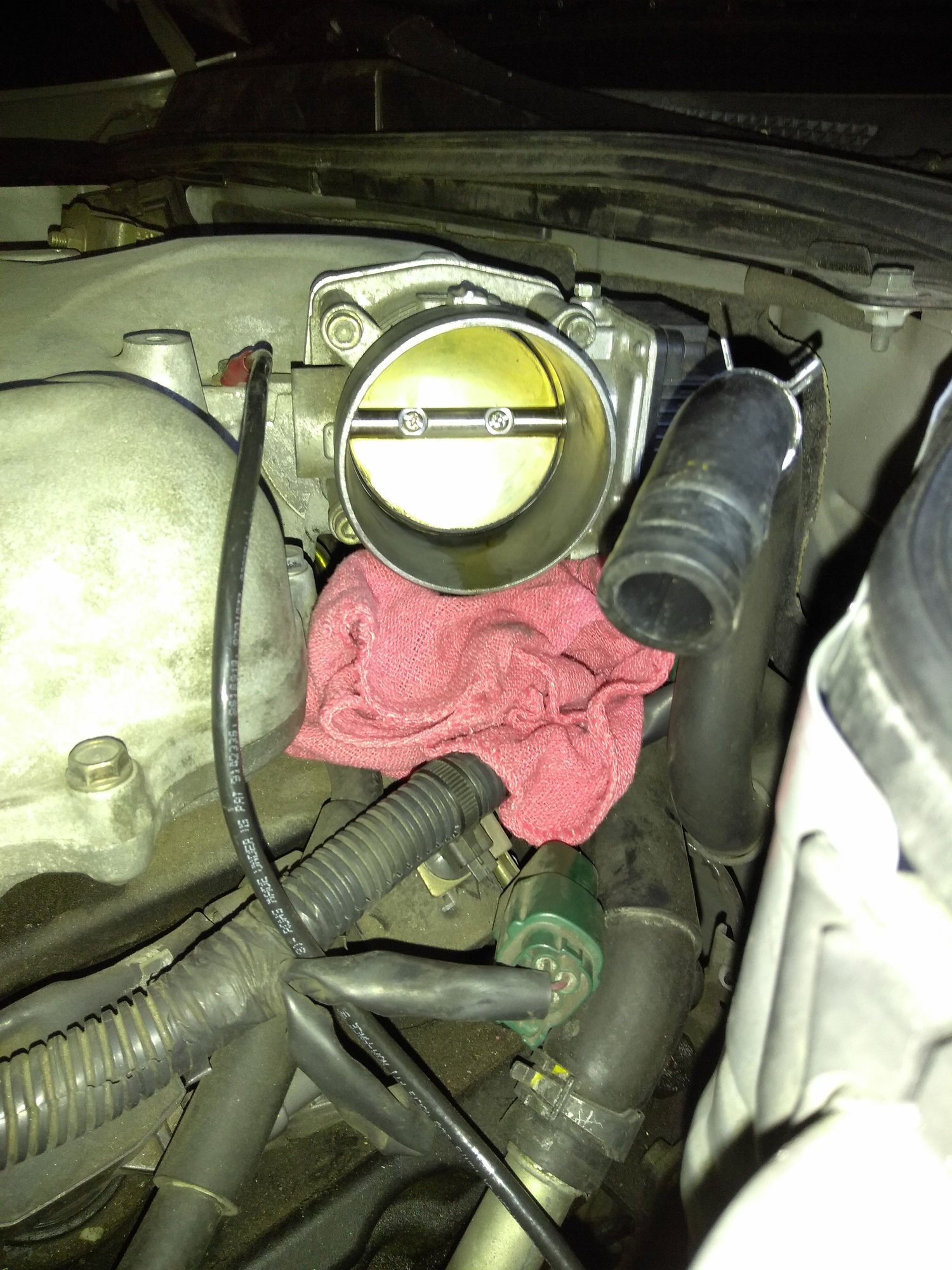

Update
Took car to AutoZone to have battery and alternator checked in car with key off and car running.
Battery voltage with car running is 14.4. Key off he said battery was reading 89% charged prior to starting the car.
Voltage readings I have are at the obd2 port which are reading 13.1 or so with car running. Maybe 13.3 at a fast idle.
Car still throws the TB acuator code 1121 every time I start the car. Once cleared and I turn car off and back on vdc and slip lights go off and car is out of limp mode.
So what we know is battery and alternator are fine. If obd2 port voltage is accurate than there is a voltage drop. This damn TB code is what's killing me. If the car is off longer than 5 minutes the code will pop up again. If I wait 30 seconds or 1-2 minutes after cutting car off to turn the car back on the code will not pop up.
I decided it's time to clean the mag and TB. TB butterfly is not 90 degrees closed with the car off. It looks open about 10-15 degrees just gueasing.
Here are pics and I have never unplugged the TB or touched the butterfly, not even came close.
Car off immediately after removed air intake.

If you clean it don't turn it on, but put the pedal all the way to floor. It should open it up and then you can clean it with a toothbrush or something. I wouldn't mess with it by hand they are real finicky. You'll probably have to redo all the relearn procedures and good luck with that!

I unhooked the battery. So explain how to get it to open with engine off. Key on and put pedal to floor and it will stay fully open? Looks like somebody used the wrong alan wrench and somewhat rounded a hole in the top right bolt as you can see in the pic. So I'm gonna have to try to clean it with it still installed. Its filthy black coated inside when I put my head in there and look up. Its bad bad coated with carbon. I really hope this is the issue for the P1121 Code that always comes back when I start the car up. But stays off as long as I don't turn the car off. So its baffling me. The issue has no impact on idle or driveability. Its perfect with the code cleared. My gas mileage is horendous. Highway average is 14.5 and thats 60-65 MPH.

Well, I'd hook the battery back up and turn it to the on position and then put something to hold the pedal down. That way it's WOT and you can get in there with a toothbrush or something, I cleaned my throttle body once on my G by manually moving it and my idle got all jacked up and took forever to fix. Some people have broken their throttle bodies doing it that way as well.
I used the method I told you to clean the RAV I'm working on for my brother and didn't have any problems. It also fixed a fluctuating idle problem I was having.
It could just be you have a bad throttle body already and that's why the code won't go away. I know if the throttle body is bad it disables a lot of stuff for safety measures. Try looking into remanufactured or used throttle bodies as well.
Try using some vice grips or see if you can hammer the next size allen wrench in to the bolt.
