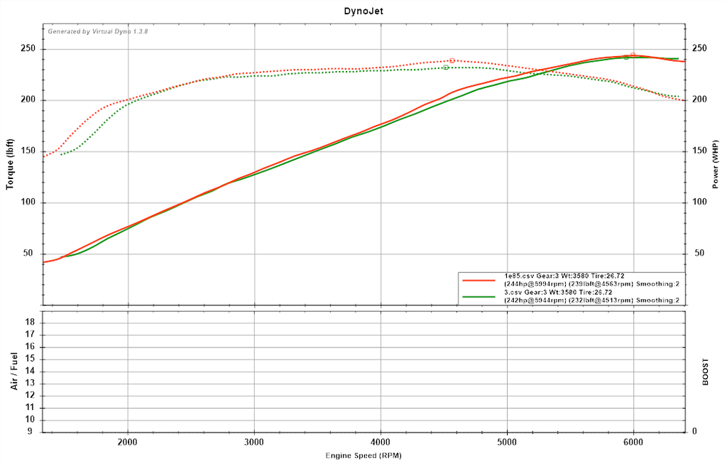

I finally got a chance to datalog a couple clean 3rd gear pulls and overlay it with my 93 octane pulls. The results were pretty underwhelming really. It looks to me like E85 may have gained a little bit, but not enough to be conclusive from a datalog.
E85 in Red, 93 in Green
I'm going to keep messing with it and I'll continue to update. I'm looking forward to seeing what happens with gas mileage but it's going to take me a while to get any kind of relevant data on that.
