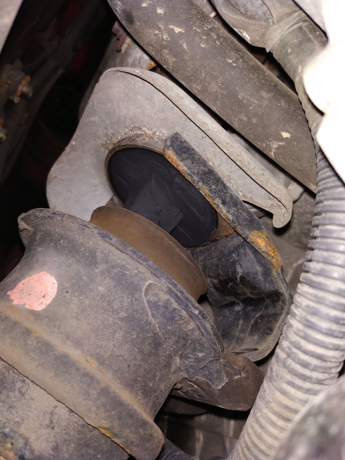

I was using a hydraulic jack.... could of been alot worse!!
anyways... i jacked up the car and checked it out....
seems like it's just the motor mounts! thank god. any recommendations? I saw some aluminum ones on ebay for $100.... rockauto has aftermarket replacements for $50...
also the oil pan is a bit bent... i don't think it will effect anything, no cracks, leaks.

Yep those mounts are definitely FUBAR, I would tackle this repair with a engine bar like this.
https://www.amazon.com/Dragway-Tools-Transverse-Transmission-Transaxle/dp/B004UC6NLE/ref=sr_1_3?keywords=engine+bar&qid=1557023684&s=gateway&sr=8-3 https://www.amazon.com/Dragway-Tools-Transverse-Transmission-Transaxle/dp/B004UC6NLE/ref=sr_1_3?keywords=engine+bar&qid=1557023684&s=gateway&sr=8-3
It sits on the hood rails, set it to the uppermost position with those adjusters and then you can let the tension off to lower the engine back down when you have the new mounts on.
You will likely need a torque adapter to get to some of the bolts. They look like this.
https://www.amazon.com/Tools-93222-Metric-Torque-Adaptor/dp/B00NABVES8/ref=sr_1_4?keywords=torque+adapter&qid=1557023758&s=gateway&sr=8-4 https://www.amazon.com/Tools-93222-Metric-Torque-Adaptor/dp/B00NABVES8/ref=sr_1_4?keywords=torque+adapter&qid=1557023758&s=gateway&sr=8-4
Honestly I would DEFINITELY not use a solid engine mount, the NVH is pretty crazy, I have the Z1 Motorsports urethane ones and it's as firm as I would go. If you don't want all the extra NVH then stick with an OEM style rubber mount.

There's also a pretty good chance it F'd the transmission mount but I would wait until the engine is setting back down on new mounts before removing it to inspect. The transmission one is a piece of cake to replace fortunately.
If you haven't already start looking up guides on removing the engine mount, it's a pretty big pain in the ***.
