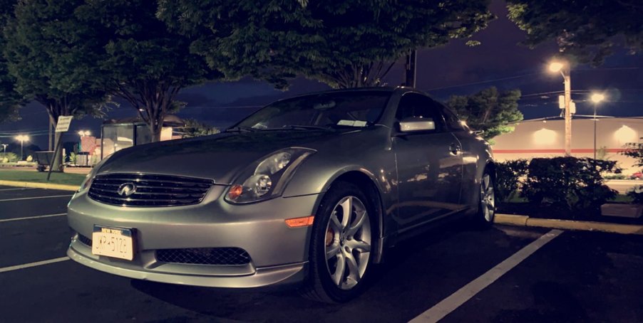

I recently purchased a used 2004 G35 6MT coupe (129kmiles). So i have a few concerns the car for the most part is amazing happy to finally own one considering ive wanted this car since middle school! So first on the list of concerns is
1.my trans tunnel gets warms i can feel hot air while driving coming from that area
2.the guy i bought it from put a really cheap clutch from ebay and while accelerating i hear a rattling at low rpm (i believe its clutch chatter mixed along with noise from the throwout barring
other then that the car is really clean just mainly cosmetic things thanks for any help im happy to be apart of the g community now!
Ps im a starting mechanic im comming from building/lifting jeeps so this is a new platform for me
