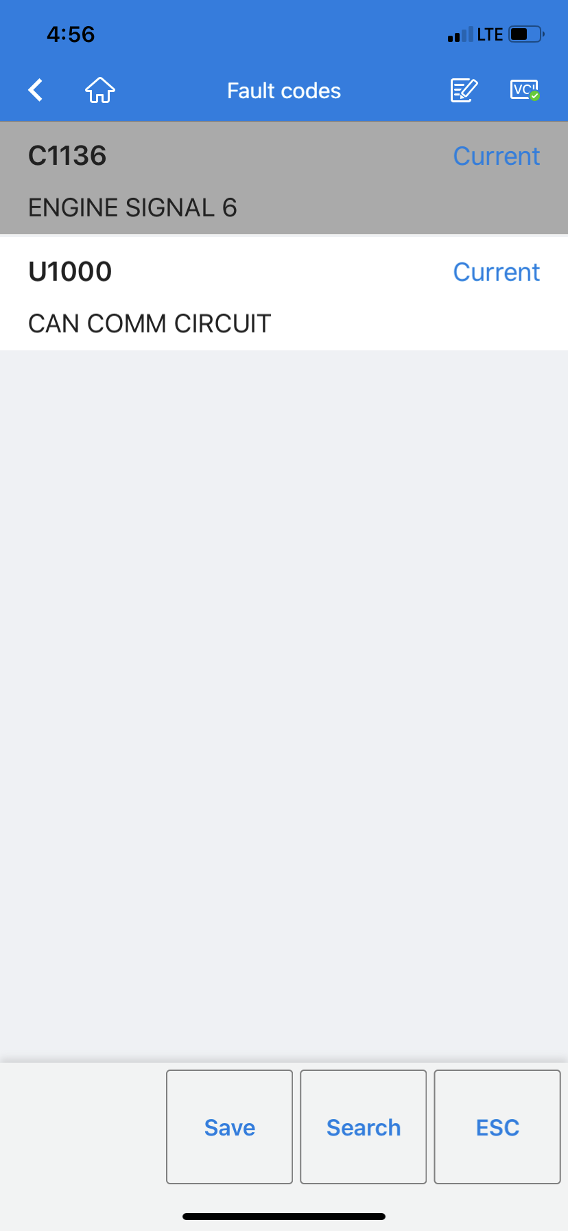

well this is just getting weirder, was just poking around the car and decided to scan again and NOW I’m getting C1136 and U1000 ABS has encountered a problem with the ECU. And the ABS light was flickering and I could hear it clicking in the engine bay and now the car won’t crank at all. Just makes a clicking sound that sounds like it’s coming from the ABS.Originally Posted by andrewl_v35
When you clear the P1065 code, does it come back up immediately when you try to start it?I know that the ECU part number MUST match... from there my knowledge is minimal whether it has to be from a MT or AT, but I'd say yes. Pretty sure it has to be paired to the BCM by the dealer.
What are you using at a ground point when you check the voltage at that pin?
@cleric670 maybe you can chime in?
