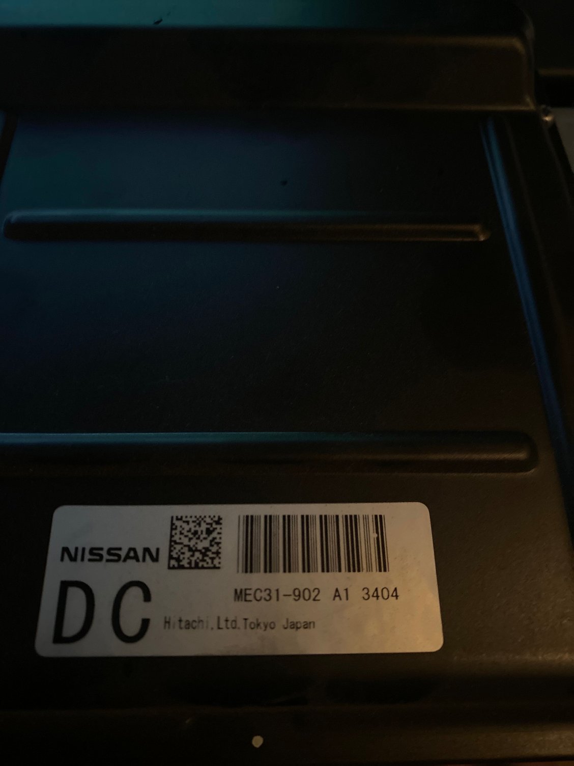

So if I replace the ecu does the ENTIRE part number need to match exactly with a new one? Or just a portion of it?
im not finding anything close, I can’t even find evidence of this exact part number anywhere. I guess I’m calling the dealership in the morning.
