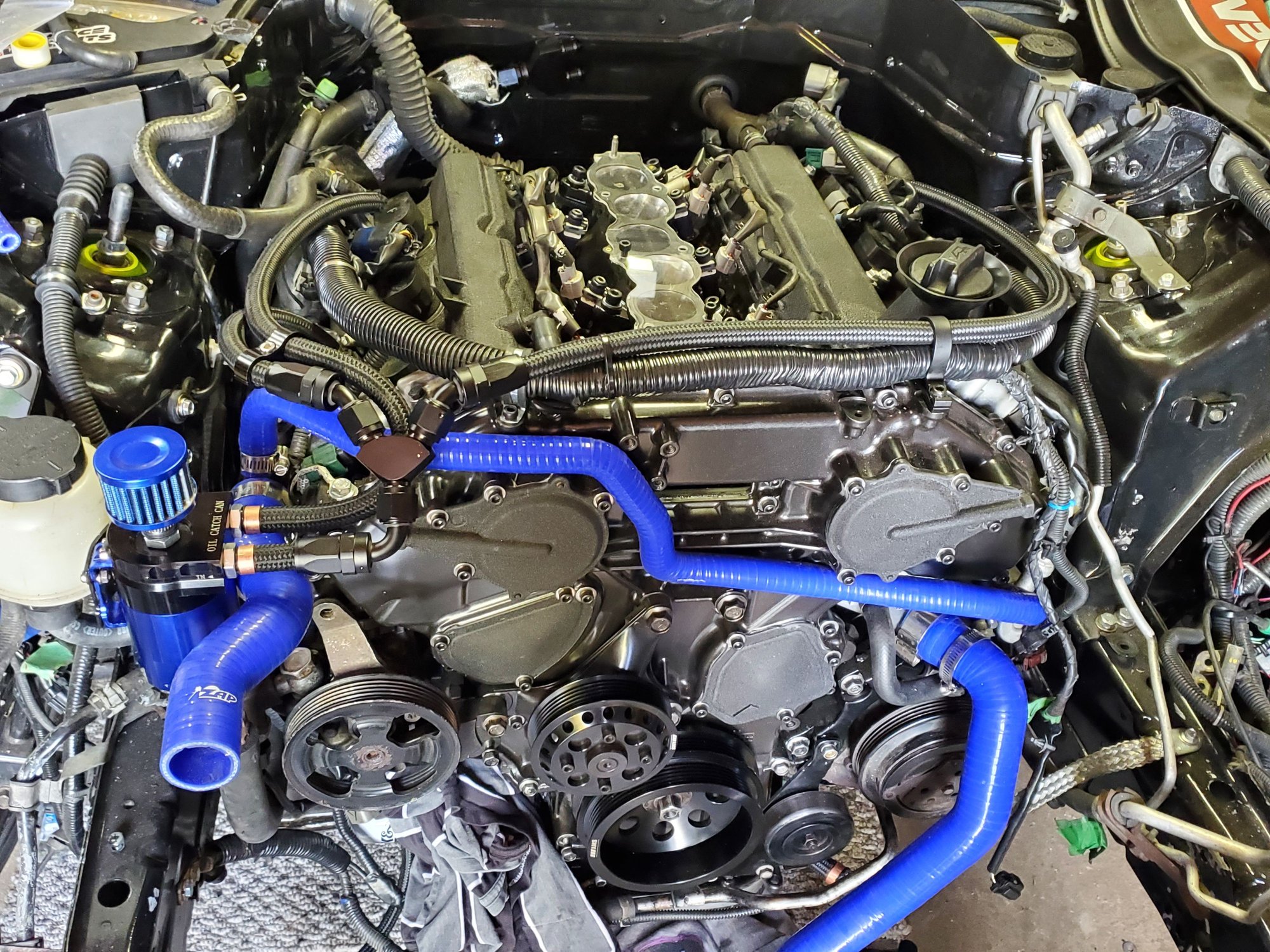

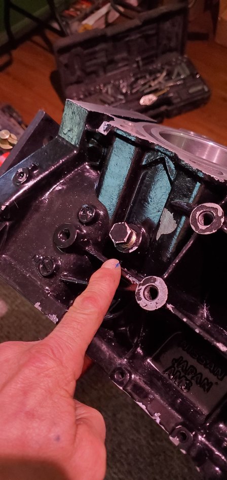

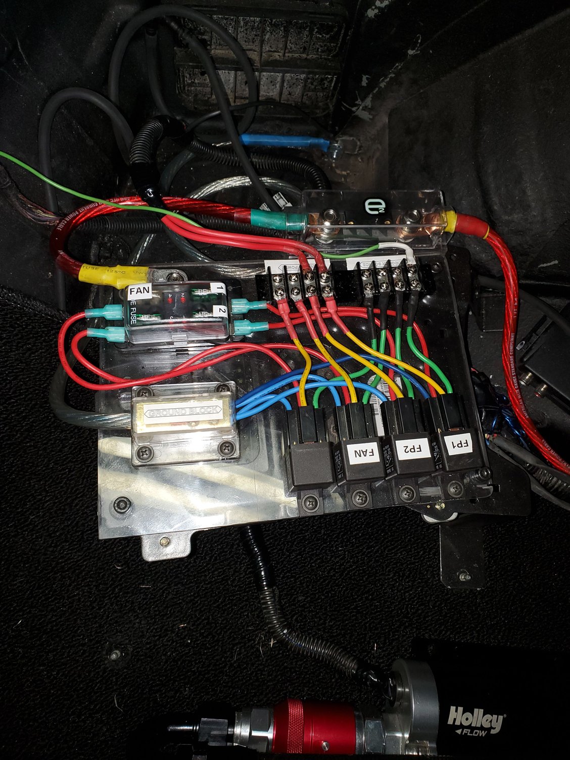

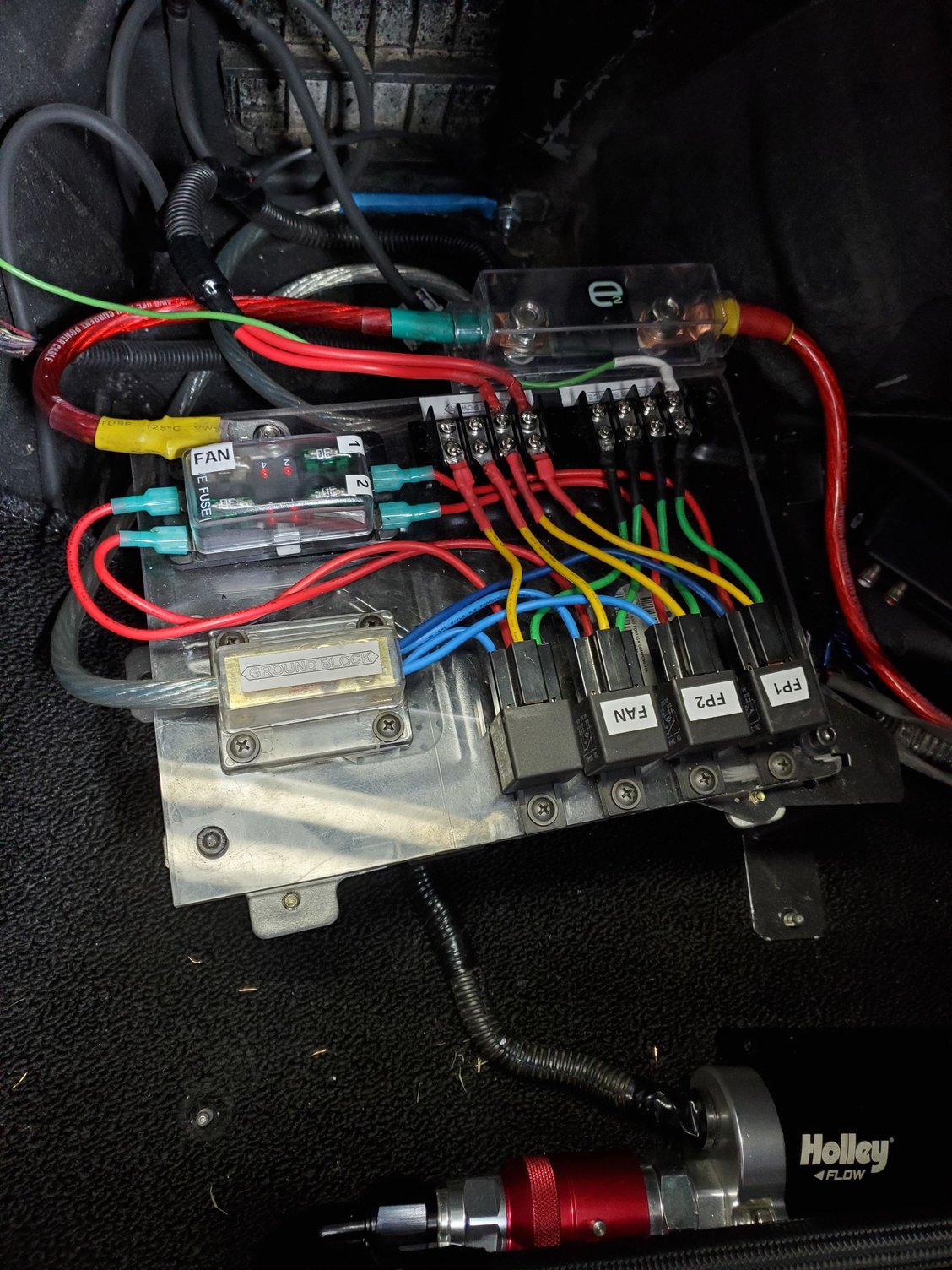

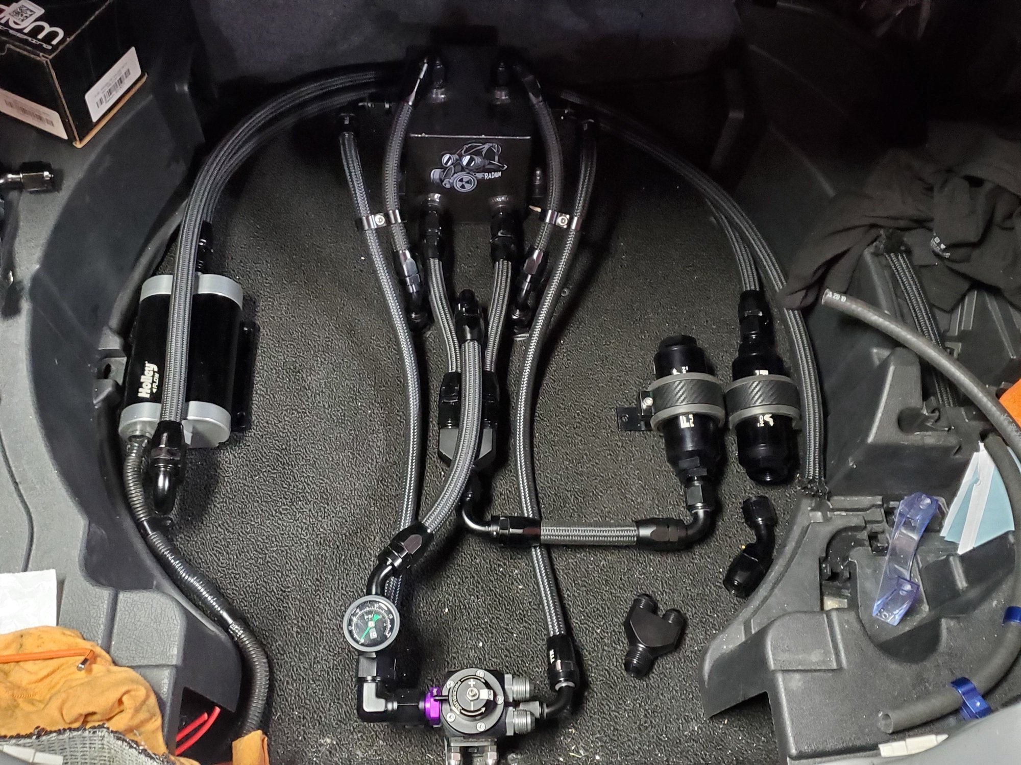

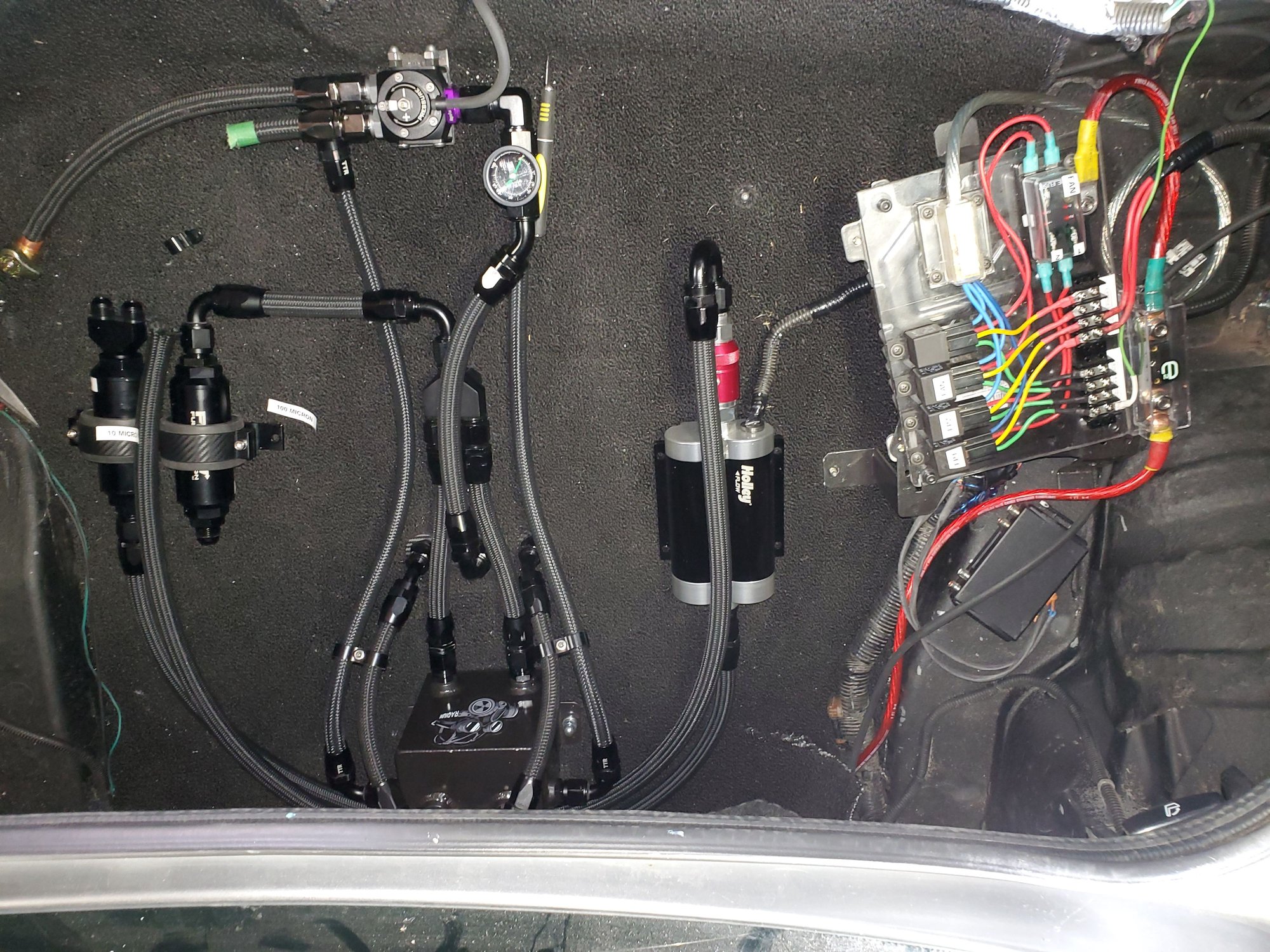

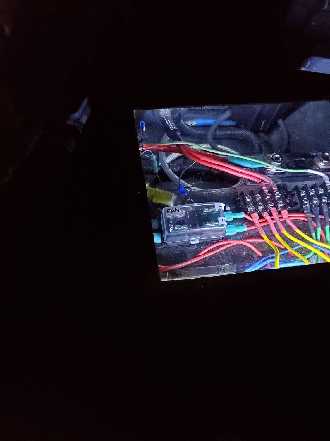

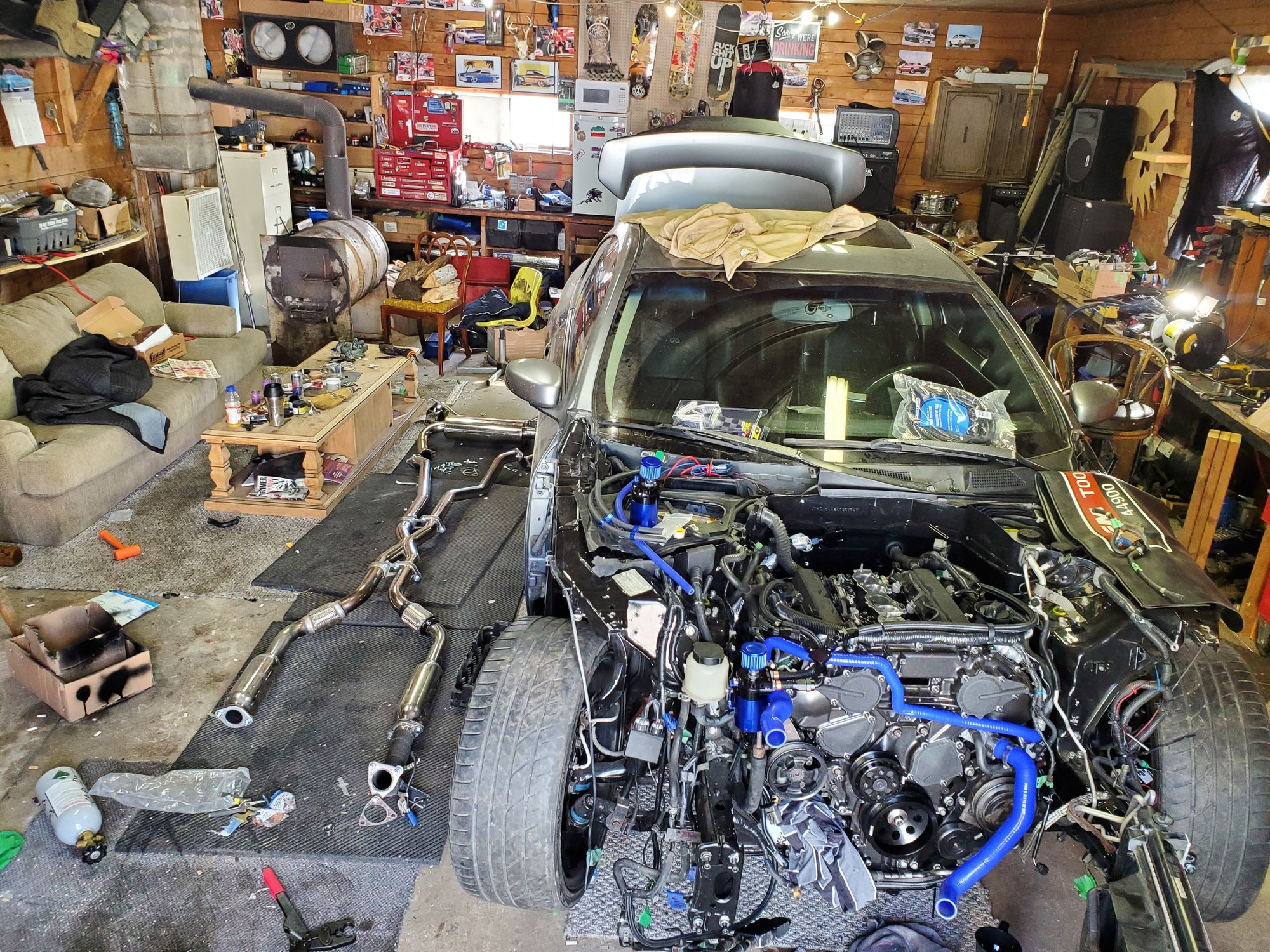

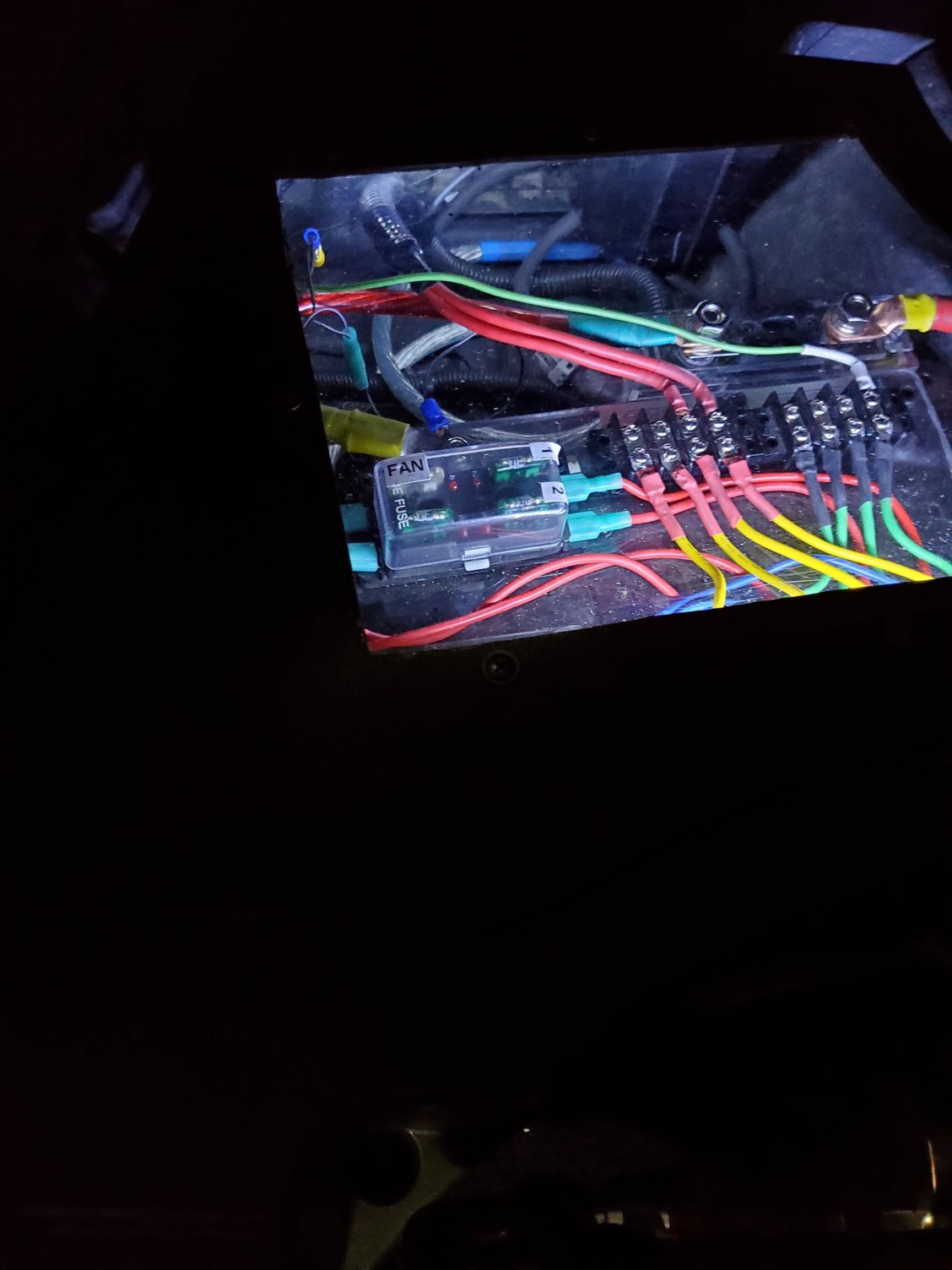

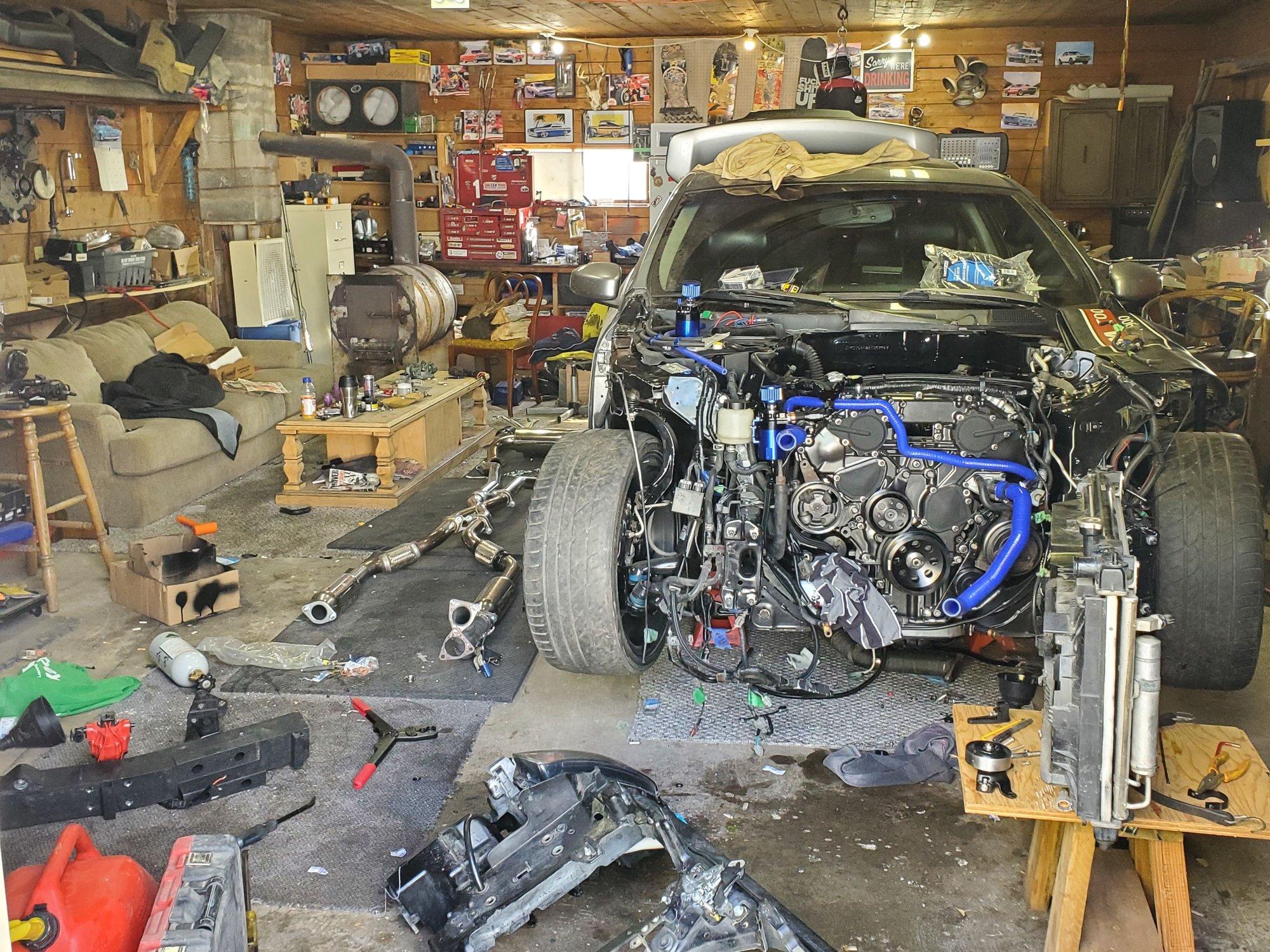

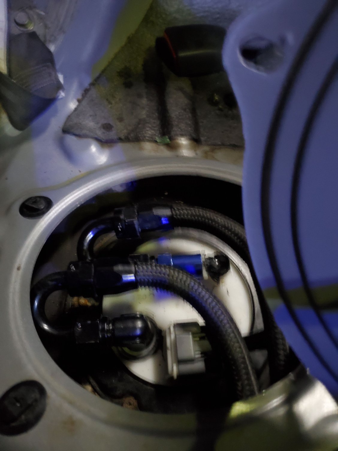

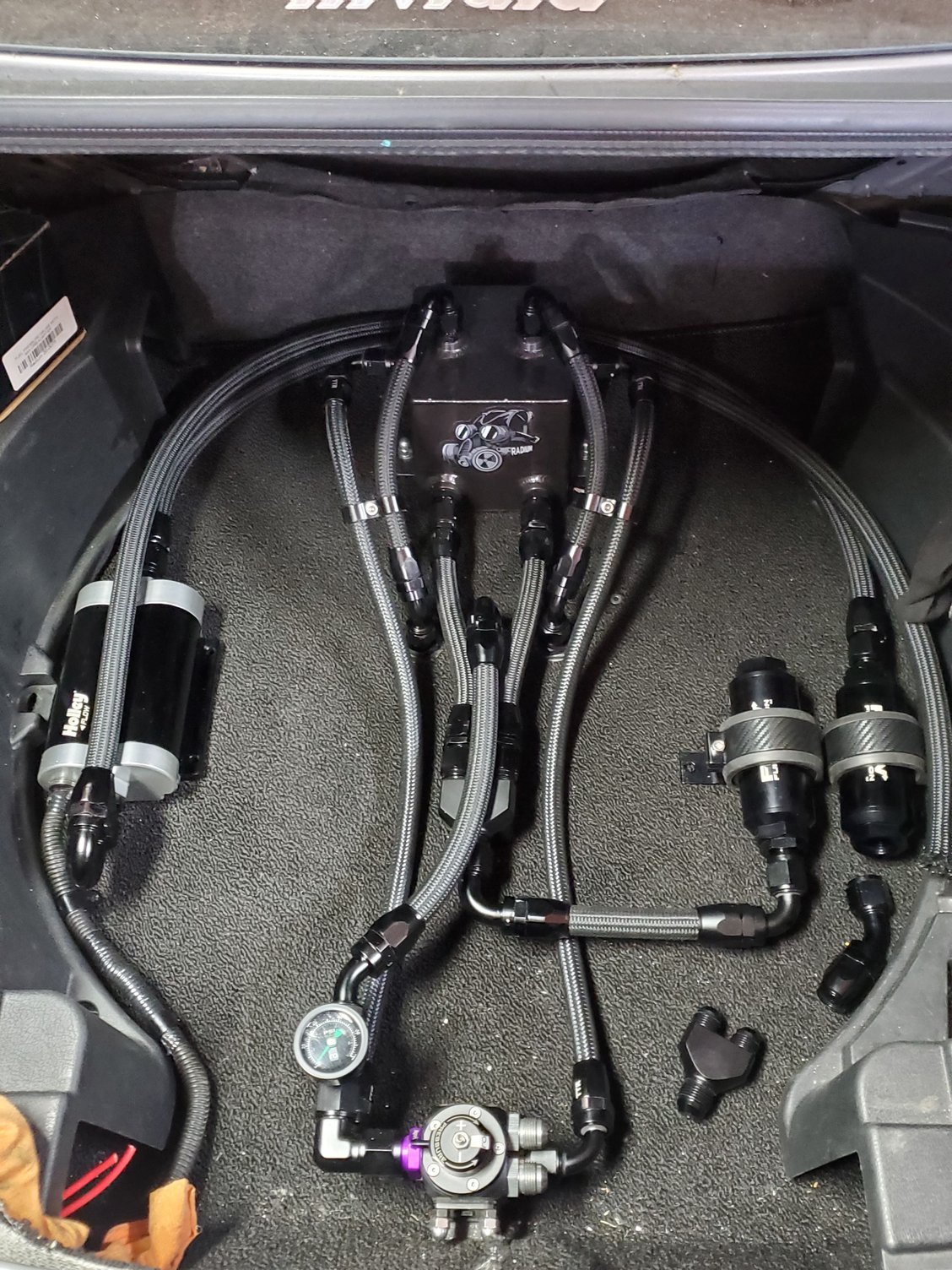

Actually I changed some parts off that list. I went full radium fuel system with Holly double pumps. And in trunk. All 10an. And a list of other parts. Hopefully pic work...
MY G BUILD
1. Rods (eagles h beam) $900
2. Pistons (JE 8.5-1) $1300
3. ARP main studs $250. ARP L19 head studs $800
4. ACL main and rod bearings $400
5. Oil cooler mitshimo $250
6. JW oil pan. Spacer $150
7. Exedy stage 2 clutch and JW 16 pound flywheel $600
8. AEM cold air intake $400
9. Gauges piller $300 with gauges
10. 2x mishmoto catch cans $300 both
11. Energy suspension bushing kit $300 front
12. Headers megan racing $400
13. INVIDIA TEST PIPE $400
14. INVIDIA EXHAUST $1700
15. PlENUM SPACER (BLOX)$100
16. Raduim engineering multi port fuel regulator.$.300.
17. All AN fittings $200 so far
18. 6-8-10 Braided lines. 33' total feet $300
19. More lines and fittings $100.
20. ANOTHER $100 on fittings..
21. Radium engineering fuel pressure gauge. And fitting $100
22 More fittings $100
23 100 for fuel check valve
$12.000 roughly, plus odds and ends
24. Fuel quick release. $100.oo
25 machine work and balance and blueprint $1400.00
26. pre lube pump.$ 200.
27 Timing chain kit $800
28 rev up oil pump $300
29 fuel. Cell/surge tank $100
30 fuel correction kit 100.
30 cosmetic MLS head gasket and full gasket kit $695.00
31Holly dominator fuel pump and fittings. $741.00
Plus 485 for 2 filters and fittings with heat sheild
So far $18.300.00 plus in upgraded top of the line parts

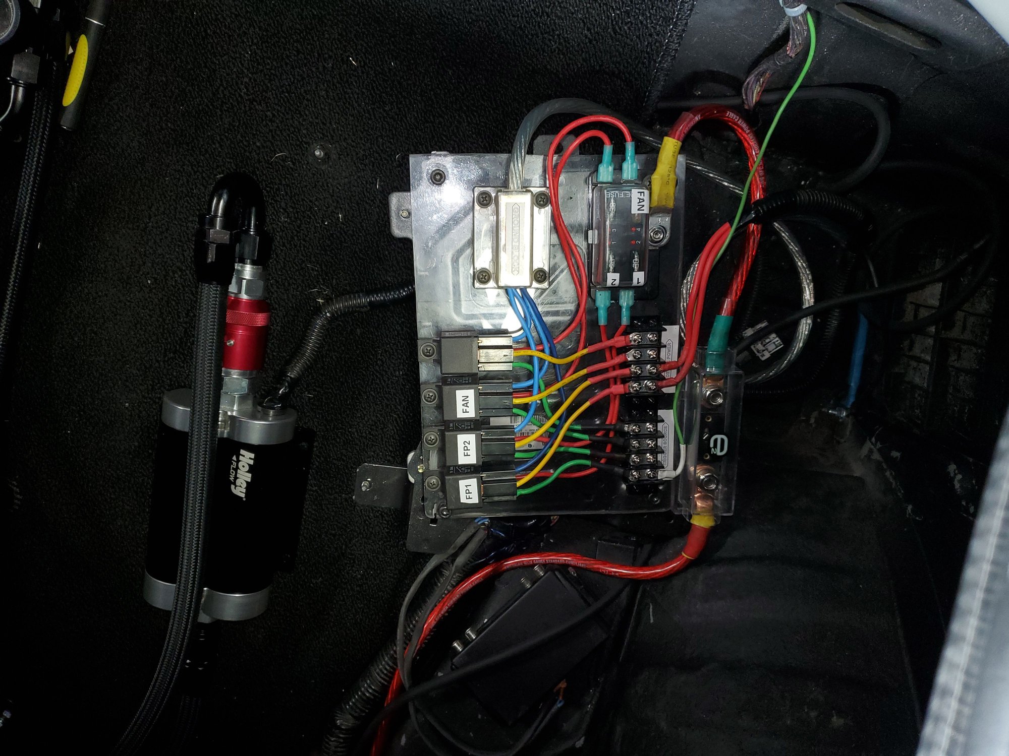

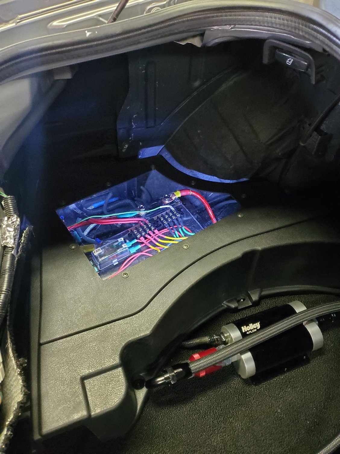

Just some build updates from here in the great north...more pics to come..fuel system upgrade. (Holly duel pump with pre and post filters) Fully built long block. Power/fuse/relay panel in trunk. Rev up oil pump upgrade, too many to list. But heres a few on the new list...
