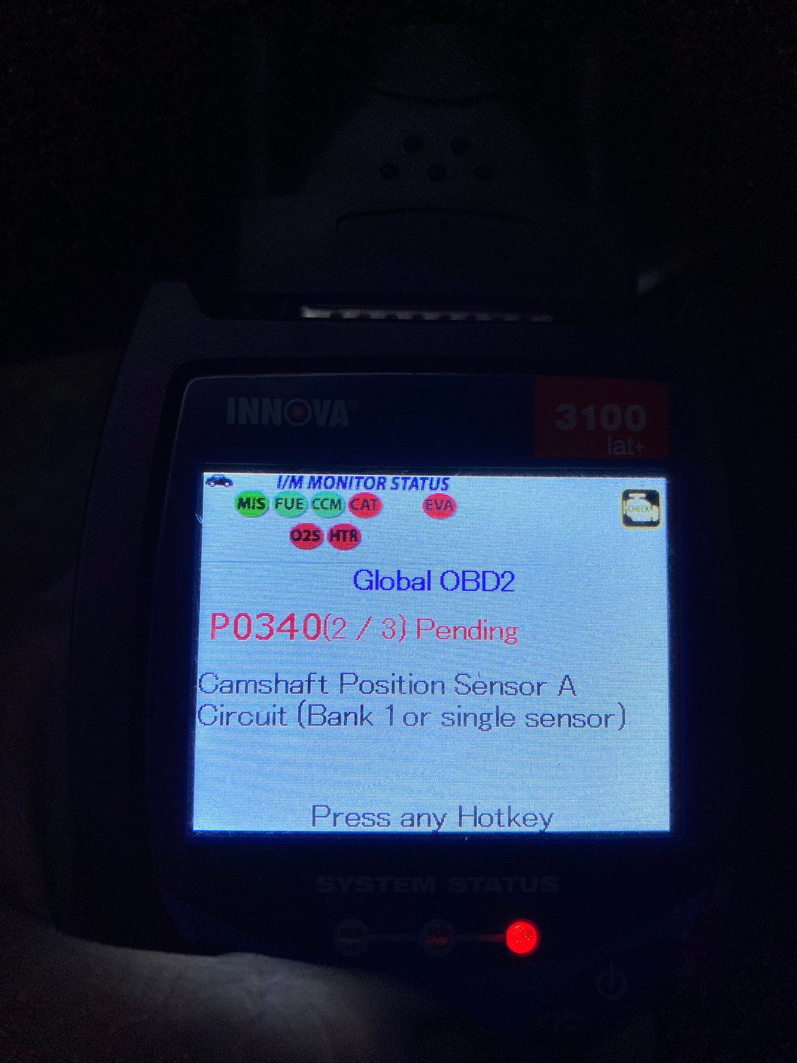

Chain/tensioners were installed correctly, all timing marks lined up correctly even after rotating and letting sit and rotated again. After everything was reinstalled, car would crank but zero attempts to fire. Pulled codes and got p0340 p0345 camshaft position sensor bank A and bank B. Replaced both sensors, still the same no attempt to fire. Brand new spark plugs. Everything has been checked and rechecked that it was installed and plugged back in correctly. Even checked the battery to make sure enough voltage was being seen by the CPS. Kind of at a loss here, ANY input would be greatly appreciated.

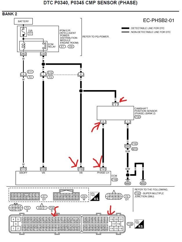

Next step is to ring out your cam sensors back to the ECM to verify the wires aren't broken.
Bank1
is the orange and pink wire back to the ECM, harness is shown at the bottom of the diagram. Black wire should have continuity to ground.

Sep 17, 2020 | 11:43 PM
Bank 2 is yellow and pink, black is still ground, here's that diagram.

If you aren't familliar with "ringing out wire" what you need to do it get a digital multimeter, set it to OHMS. Then take one probe and put it in the ECM harness (battery disconnected, ECM harness and CMP harnesses unplugged), then put the other probe in the CMP harness. You should have the same value on the screen as if you were directly touching the probes together, usually ZERO or ONE ohm depending on the meter. Test for value before you actually ring the wire, just touch the two probes together, that's the value you should see.
If you have a broken wire then it won't change the value of the meter, you also need to test the ground pin 1 black wire on the harness, ring it back to the negative battery cable.
It's called "ringing out the wire" because most of your professional meters make an audible tone when you have continuity. You don't need a fancy meter for this, a $5 Cen-tech meter from Harbor Freight will work just fine.

sorry it took me so long, I got really busy with work. Ok so something very strange is going on. I went to test for continuity, and when I pulled the the ECM wiring harness the female pin is missing for 119? Where I’m supposed to be testing? I know it seems really strange but here is a photo.

no I haven’t. There’s supposed to be a pin from what I understand in the pin slot 119 that runs back to both Cam angle sensors. But the pin appears to not be there. I am kind of at a loss. I’ve tested resistors and checked fuses. There is just no communication to the sensors.
