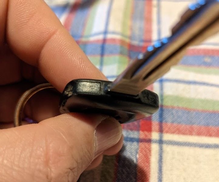

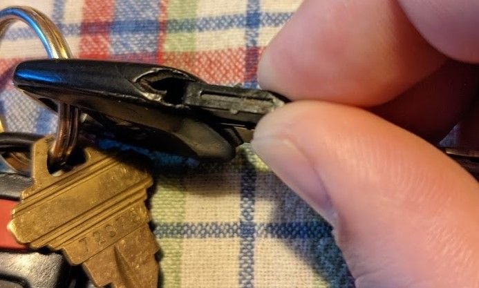

Not really, it's pretty straightforward, the ECM and BCM and programmed together as a matched pair (NATS/IVIS security stuff), the BCM is programmed to accept a specific set of key RFID chips (embedded in the side of the key), the lock cylinder is also physically cut to accept a specific key.
If you want to keep your existing keys you can swap the RFID tags, then you're just looking at unplugging and swapping the ECM and BCM. I'll go dig up my keys and post a picture of where the chip is located, you usually need to "chip away" a little bit of plastic to get to the side of the key so you can get a flat screwdriver into the slot to pop it out.

You can probably get the RFID tag out without butchering your key as badly as I did. The RFID tag carrier is the part that pops out of the key, the tag itself pops out of the carrier and has the tiny words printed on it.
