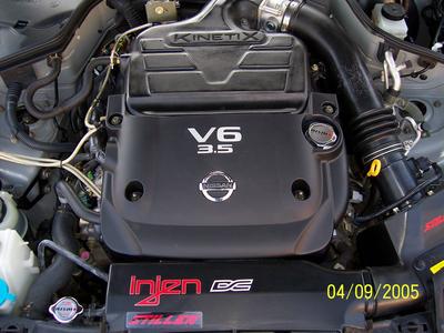

here is mine

SLVRG35: so the 350z cover fits perfect or must be modified?
Old Nov 4, 2005 | 01:04 AM
SLVRG35's Avatar
Joined: Jul 2003
Posts: 227
From: Moore, OK
No modification needed for mine

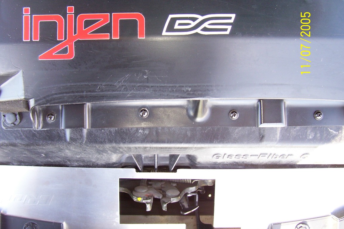

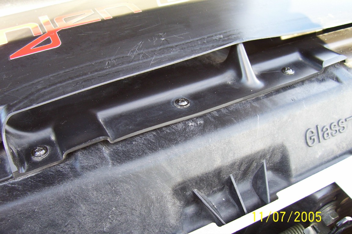

damn that looks sweet!!!!!!!!!!! Did u have to get different washers and screws or did u use your stock ones? Also, i heard the cover is close to the fans is that true and does it rub?
I used the original ones. The cover did rub the the air ducts on top of the radiator, but I fixed that with a few screws. I'll post a pic later today.

I put a spacer between the cover and air duct then put 4 screws in the front edge of the duct and removed the spacer, no more rubbing.
Attached Thumbnails Kinetix plenum and engine cover-air-duct1.jpg   Kinetix plenum and engine cover-air-duct2.jpg
