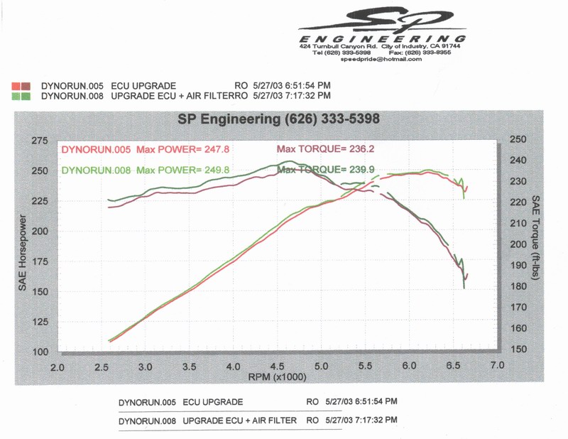

This is especially true for a re-programmed ECU for which we haven't any "real world" info as yet. A couple of postage stamp sized dyno charts (350z) on an unfamiliar dyno doesn't tell us anything.

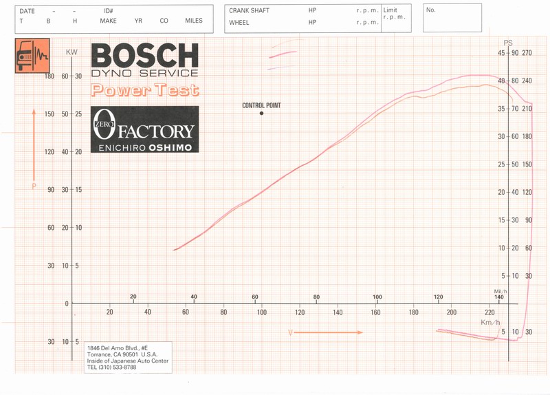

The chart for the G35 is larger but still uninformative. Which color is which ECU? What gear was the run in, 5th? Manual or AT? What RPMs? What AF mix? What was the HP & FT/LBs? Most of us here to the East of the Pacific don't relate to KiloWatts as a measure of power. And what is PS anyway?
Hey Cheston, are you lurking? Can you get Technosquare to answer these questions and translate they Bosch dyno charts into DynoJet oriented data? And while you're at it, remind them that other companies have come up with solutions to reprogram unreplacable ECU chips without "throwing out the baby with the bath water" (I.E. not giving away a hackable program). A simple "flash" module that backs up the current ECU program, modfies that program on the ECU but which won't reprogram another ECU until the original program is restored back to the original ECU. That's what a company called HyperTech did for the '94 - '96 ImpalaSS ECUs. Now their "flash" module would let us alter the autotranny's shift firmness, program the rear tire diameter to correct the speedo, indicate whether or not we had the 180f thermostat, change the primary and secondary "fan on" temperatures in addition to selecting "performance" mapping or "stock" mapping of fuel/air/ignition tables. All for $295. They charged just a little more for the '96 model for that's when the ImpalaSS switched to ODB-II (or was it ODB-I).

the color of the ECU is black. its the 'bigger' of the black boxes inside the passenger side flooring.. the gearing for dynos are run for MTs in 5th gear, or ATs in 3rd (or 4th, need to double check).. the Bosch dyno is quite difficult to read, its basically the lines underneath the axis, you add to the top of the graph at its highest point, then multiplied by two... but its very confusing.. they will have a dyno jet graph soon.
PS is a unit similar to HP.. the conversion is almost 1:1 or 1.1 to 1..

G35 Page (the large dyno image is accessable):
http://www.technosquareinc.com/g35.htm
350Z Page (none of the large dyno images are accessable):
http://www.technosquareinc.com/350z.htm
And for those of us running Netscape 7.x, IE6.x and/or Opera 7.x who can't open the large images of the dyno charts.
DynoJet 350z "track" run:
http://www.technosquareinc.com/image...ges/350ECU.jpg
Bosch run:
http://www.technosquareinc.com/image...s/350Bosch.JPG
DynoJet 350z "track" run with custom air filter:
http://www.technosquareinc.com/image...0ECUFIlter.jpg
