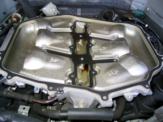

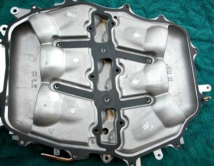

I've removed the upper collector from more than 25 VQ35DE engines and all had oil inside the lower collector. Most had an oil film on the upper and lower collector surfaces. Some had oil pooled in the lower collector troughs. All had oil in the oil gallery under the cad plated steel cover. There are six holes in the gallery that allow the oil to be drawn from the PVC valve through the oil gallery and then into the intake runners. Oil in the combustion process lowers the gasoline's octane and causes pinging. An oil catch can should be installed between the PVC valve and the lower collector's steel tube at the front of the lower collector. Most people install it between the drivers side valve cover and the intake tube. Check out the attached pictures. I'm hoping to have a G35 specific oil catch can built complete with condensing coils and all the plumbing. The setup IM working on will have a vacuum at all rpm ranges and will not pull any oil into the intake charge. Controlling crank case pressure is my main goal with the benefits of no oil in the intake track. Understanding that owe PVC valve only works at high vacuum levels and does nothing at "WOT" is the biggest challenge. Oil passed by the valve seals and controlling oil pushed by the oil rings by high crankcase pressures will produce horse power gains at higher rpm's. I may not believe that the simple catch can design is the best, but it sure beats the hell out of the stock PVC setup. This project is in the works right now and will be dyno proven on some other cars besides mine. Results will produce HP.

My Maxima's intake manifold would collect well over a tea spoon of oil with low areas containing standing oil. Every Maxima with this particular intake manifold showed the same thing. My Maxima never pinged unless I intentionally lugged it at a really low rpm. My G has never pinged once.

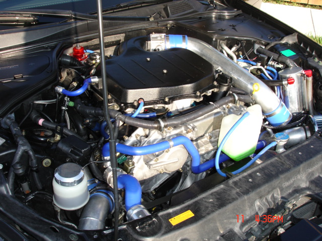

I am not going to get into the discussion about if you need a catch can or not, but here is a picture of my greddy catch can. If you change the OEM intake you should be able to put it in the same place.

As i understand it, the general concensus is that an oil catch can inserted between the PCV and lower collector will not GREATLY benefit, but can generally help to prevent issues and maintain the engine. Do i have that roughly correct?
As far as the pictures go, thanks for the various input and suggestions. Gman, it looks like you have alot going on under there! I see you also relocated some of your resevoirs. In having the catch can over by the intake, did you run into issues running the hose, or are you running the lines someplace else?
Yeah I have the greddy kit which replaces the factory resevoir. As far running the hoses there is no problem. I am not mechanically incline so I don't know where that black hose on the left goes, but the clear hose on the right of the catch can goes straight down into my front bumper and ends up by the inside of the wheel well. The clear hose spits out any oil blow back.

Originally Posted by DaveB
The real question is if any of you catch users are actually collecting oil or not and if so, how much?
I can see a little oil residue in the clear hose, but it is not excessive. I have only had the catch can for 6000 miles. I am not mechanically inclined so I won't dare to open the can to take a peek.

Here's one more lower collector to add too the list.
DaveO
