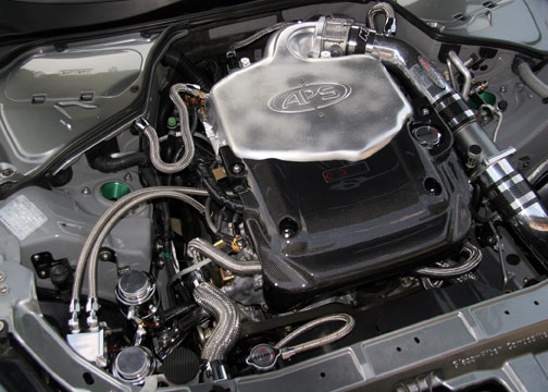

Old Jan 29, 2006 | 07:19 PM
Ninja350Z's Avatar
Posts: 44
From: Alabama
Does this help?
Here is a photo of mine installed you should have more room under the hood than I do. Anyway hope this helps.
Old Jan 29, 2006 | 07:25 PM
Lojacc's Avatar
Joined: Dec 2005
Posts: 108
From: Dirty JERZ!!!!!
wow...gorgeous engine bay, bro. looks like you have ALOT going on underneath there!!
see, thing is, i f'd up by getting the vertical can. even still, i did not consider putting it directly behind the radiator. i will give that a shot and see how it works out.
thanks alot for the input guys!
