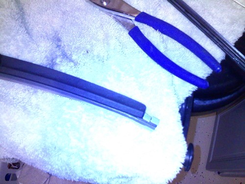

My first attempt at a "how-to" post so bear with me. Sorry for the poor pic quality but here's what I was talking about. You can replace just the blade inserts in the "blade assembly."
First, remove the assembly from the wiper arm (as described by others in this thread).
Pic 1 - Get a pair of plyers and grab the end of the blade. Pull up on it slightly and then slide it out of the blade assembly.

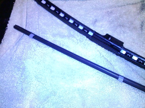

Pic 2 - You'll notice two "tabs" on the blade refill. DO NOT REMOVE THESE! They hold the wire support blades in place.

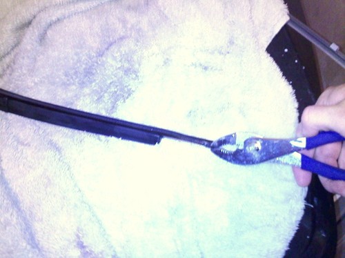

Pic 3 - There are grooves on the sides of the refills that slide into the blade assembly. They sort of click into place as you slide the refill in.

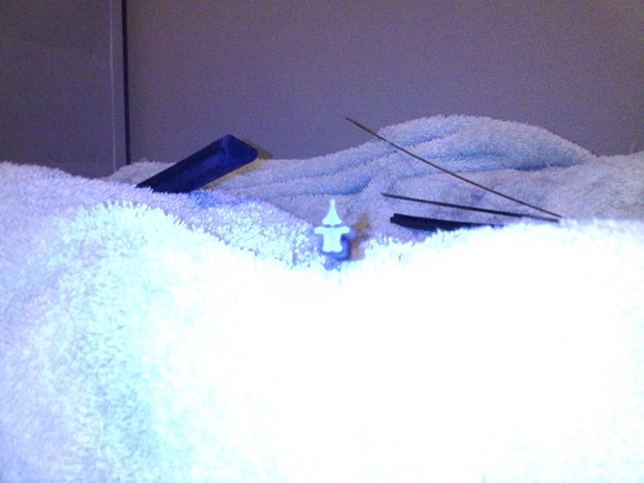

Pic 4 - The tabs will work their way down the refill as you slide it into the assembly. Remove them when they get to the end and slip the end into the assembly.
Done!
Whole process took me about 5 minutes. It took longer to take the pictures. lol PM me if you need more info. The pair of refills cost less than $14 from Infiniti.
