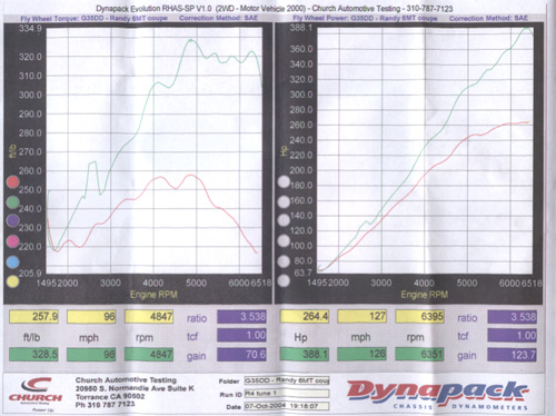

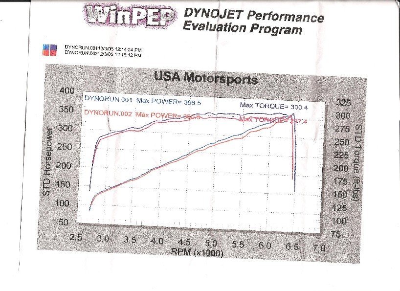

Stock Vortech pulley, everything else is in the sig...
Dynapak dyno (91 octane) = 388/328
Dynojet dyno (93 octane retuned) = 366/300
Attached Thumbnails vortech supercharger question-dyno1.jpg   vortech supercharger question-jonsg_dyno366-300sm.jpg

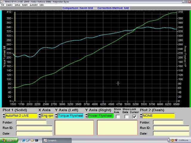

Vortech Dyno
Dynapack dyno (numbers shown are actually at the rear wheel, not at flywheel as shown on chart).
410rwhp/340rwtq
Fully Built motor (by Scott @ Ballistic Mototrsports), 3.12 pulley, headers, Hi-flo cats, stillen exhaust, crawford V5 plenum.
Tuning done by Giles.
