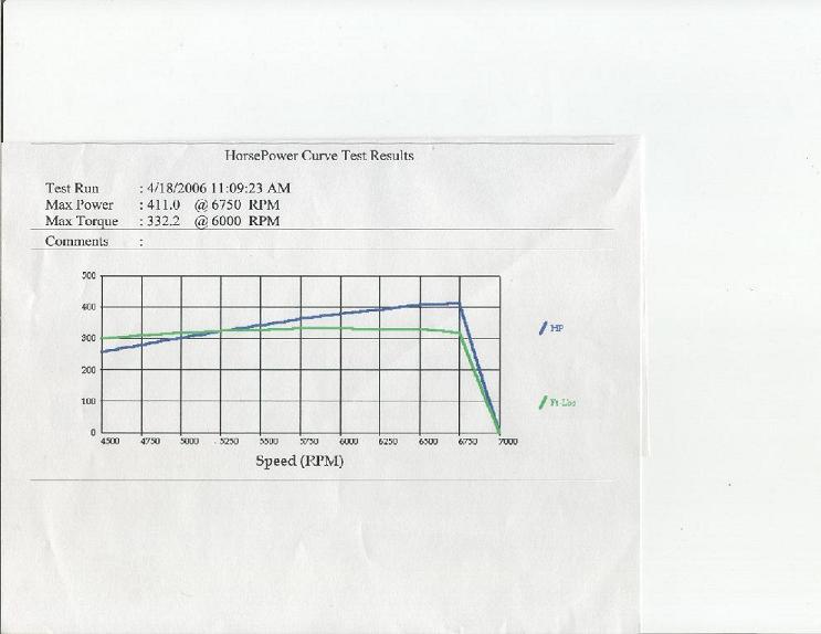

Originally Posted by sentry65
sounds good.
I'd love to see a T-trim dyno to compare it to a SC-trim with different pulleys
I have mine here . I'll see if I can scan it and post . I dont think it has A/F and boost levels though

Here yopu go . this was the power curve run . It made about 10 peak whp less because A/F drops with more load on the motor
