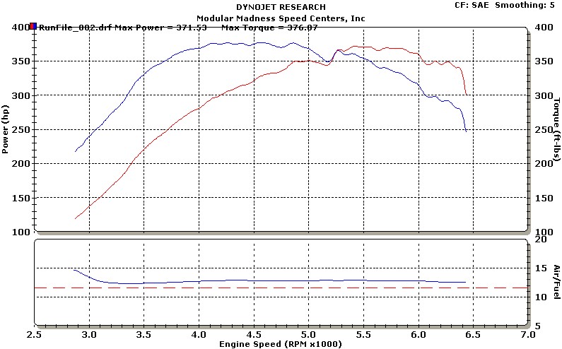

here's one:
http://us.st11.yimg.com/us.st.yimg.c..._1901_93928177
tHis graph is froma greddy kit. his power curve is plateauing at around 5500 rpm. I have seen other greddy dynos like this, too.
The dyno graphs on the JWT kits that MRC is doing seem to follow the natural powerband of our cars. Maybe the JWT is better design. not sure, I've never seen it.

another reason the torque plummets is becuse it's a fixed PSI.
actually the boost hits peak boost at around 3500-4000 rpms usually, then will gradually drop as it hits redline - a small drop as in only losing 1 or less PSI from 4000 rpms to redline
a centrifugal on the other hand keeps increasing boost so you end up with a very very flat torque curve from about 4500 or 5000 to redline
sentry, if the psi is fixed, the torque curve should mimic stock stock curve (once the turbo(s) are fully spooled up) only at much elevated levels. What I see in alot of the turbo graphs looks like a choking point in the exhaust side of the engine at high rpms.
Do you have a graph of your power curve? it would be interesting to see!!!
yeah single turbos are really choked up top
the midrange is still where the engine is the most efficient. High rpms is always never as efficient as where the peak torque is - this is why VTEC works pretty well cause it makes the engine suddently more efficient at high rpms.
