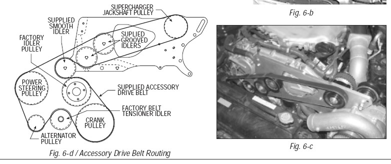

the bracket has 3 idler pulleys + 1 jackshaft pulley. The middle idler pulley wasnt spinning freely so it was making a really loud noise but as u let it warm up the noise would get better but still there. My installer told me the bearings went bad so that was the reason for the noise. We finally replaced all 3 just incase if it did happens again or there was another one almost going bad. They are around 25-30 dollars each and u can order them from vortech or even at napa or autoparts store. I read somewhere someone ordered one from summitracing. GL

thanks Mr. pharmD, looks like i will be changing them afterall.
