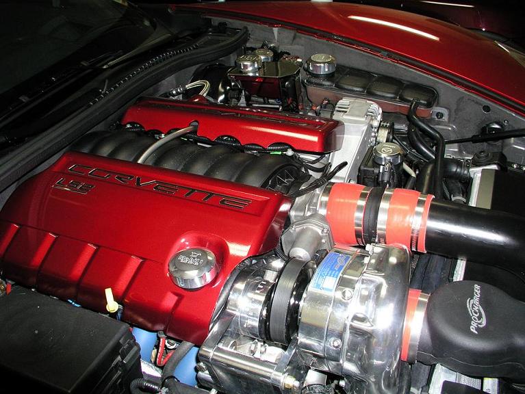

Same thing happened to my dad's pro-charged C6 when he put headers, hi flow cats and a hi flow exhaust on. SC's aren't like turbos in that a huge diameter exhaust may not necessarily help. I remember Randy's_G discovered that a few years back with his car. (I think? Maybe I'm going senile in my young age.) My dad's solution was to get it tuned (again) and change the pully to a higher boost one. I think he's got it back to the "stock" boost, or still slightly less. In either case, I think he's got enough streetable HP/TQ now.
-drew
p.s. sorry for the pseudo-hijack!
