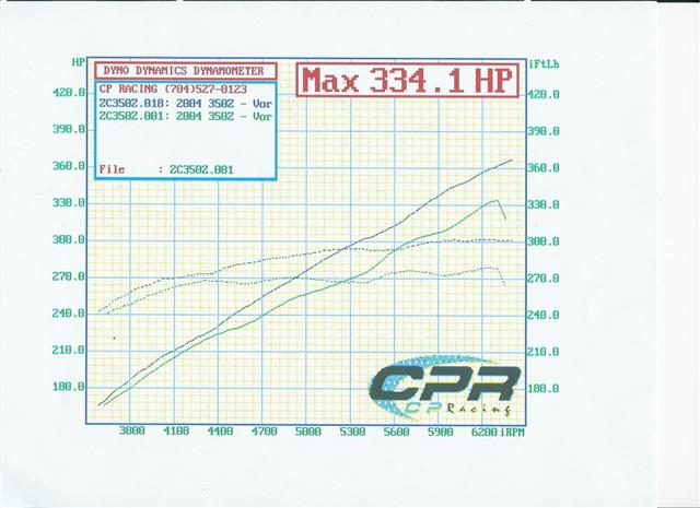

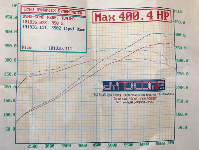

the neat thing about upgrading the pulley on the vortech - or ATI for that matter is the same power comes on 500-700 rpms sooner than before and then goes on to reach a higher amount of power in the upper powerband.
The 2.87 pulley feels like a completely different car than the stock 3.33 pulley
the stock pulley is especially boring, the tq curve is pretty flat and bland from low to high rpms. Going to the 3.12 pulley starts raising the tq curve around 4500 rpms and then it stays flat to redline while being about 30 tq higher.
well just look at these graphs - first pic is 3.33 vs 3.12 (green vs blue)- the same tq that used to be available from 4300-5450 rpms is now available at 4100 rpms and then goes up 30 tq from there which is very noticable, especially near redline
2nd pic is 3.12 vs 2.87 pulley (red vs blue) - the same tq that was available at 4200 rpms is now available at 3700 rpms
these are both dynodynamics dynos BTW - they output lower numbers than what a dynojet would
