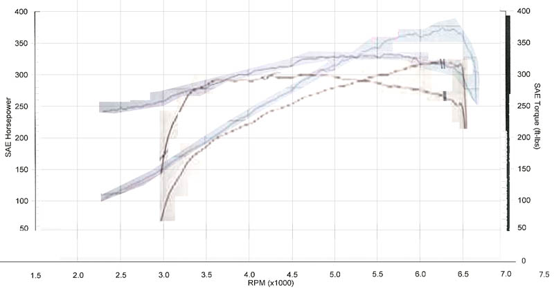

Originally Posted by sentry65
my suspicion is that if you were doing 370/330 with the vortech, even though it might feel slower driving around town, it'd probably be the faster car than a 320/300 greddy TT if you were to actually race them
Respectfully disagree....
It's all about area under the curve and not about peak HP/TQ. A turbocharged car will outrun an SC car any day even with slightly lower peak numbers. If you actually calculate the area under the curve, you will see that a turbocharged car actually has more average HP/TQ per RPM than an SC car (talking similar ballpark peak numbers) and this means that the turbo will be faster and have more power throughout the rpm band making it a much quicker car.
The BUTT DYNO is actually a lot more accurate than many think... the thrust you feel when the turbo(s) kick in is not phsycological... it's actually all that torque kicking in at a very low rpm while the SC is still building torque and that's why you don't feel that punch with an SC.
That's my 2 cents.
Great write up BTW to the original poster.
Old Aug 1, 2007 | 03:47 PM
  #24
sentry65's Avatar
Posts: 589
From: AZ
well I'd normally say area under the curve is always faster too, but I don't think it would be in this case. The vortech will have 330 tq by 4500-5000 rpms, and it would normally stay there until redline, but in this case it must have gradually dropped to around 295 tq at 6600 rpms, hence the 370whp - maybe the belt was slipping?
in this case with the greddy kit, there's going to be a lot more power before 4500 rpms than the vortech, but at its peak it'll be 300 tq probably somewhere around 4000-4500 rpms and then we all know the tq drops hard if he's making 320whp at redline which would be around 255 tq at 6600 rpms
hp = (tq x rpm)/5252
is how I'm converting hp into tq
so they cross at around 4500 rpms and then the vortech has the advantage after that actually making 30-40 more tq than the greddy all the way to redline.
let's also not forget that the power below 4000 rpms is pretty much worthless in a race. If you launch the car hard, you're either going to be launching above 4000 rpms or if you start below that, you'll only be there for a tiny bit.

it's impossible to have 300 tq at redline and 320whp at redline. It's either one or the other, but not both at the same time
Maybe the peak whp was at 6300 rpms or something? If so, then that'd mean that there's 266 tq at 6300 rpms. There's no way around it, the tq started dropping as the rpms rose
If the tq hit 300 and stayed there, then 376whp would be made at 6600 rpms
can the chart be posted up have it looked over again?

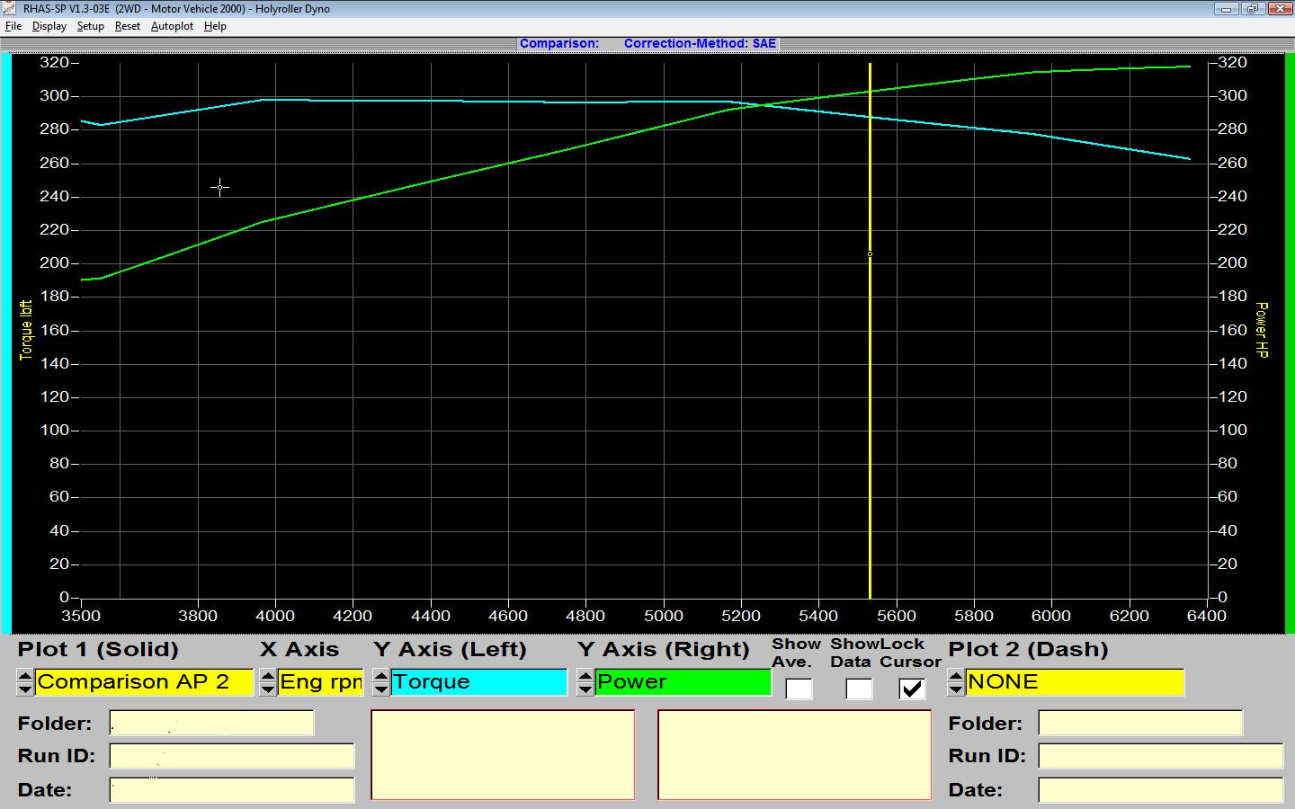

you're right...I deleted my post as soon as I posted...I'll post up the plot as soon as I find it. My plot only goes up to 6300 though because of the 5AT so 320 whp would yield 267 tq, roughly.

for the sake of some sort of visual aid, here's what I'm guessing the two charts would roughly look like compared to each other
What's not really being shown here is if the greddy started the dyno earlier, it'd extend to the left and have roughly 50 more tq than the vortech before between 2300-3500 rpms
greddy = red
vortech = blue
(this is all going to be stupid old news once the greddy TT hits 600whp)

4 psi plot...boost was dropping off to 3.5psi at 5200 to redline at the time. None of this really matters, though, as I am going to get a dyno at 8psi next week

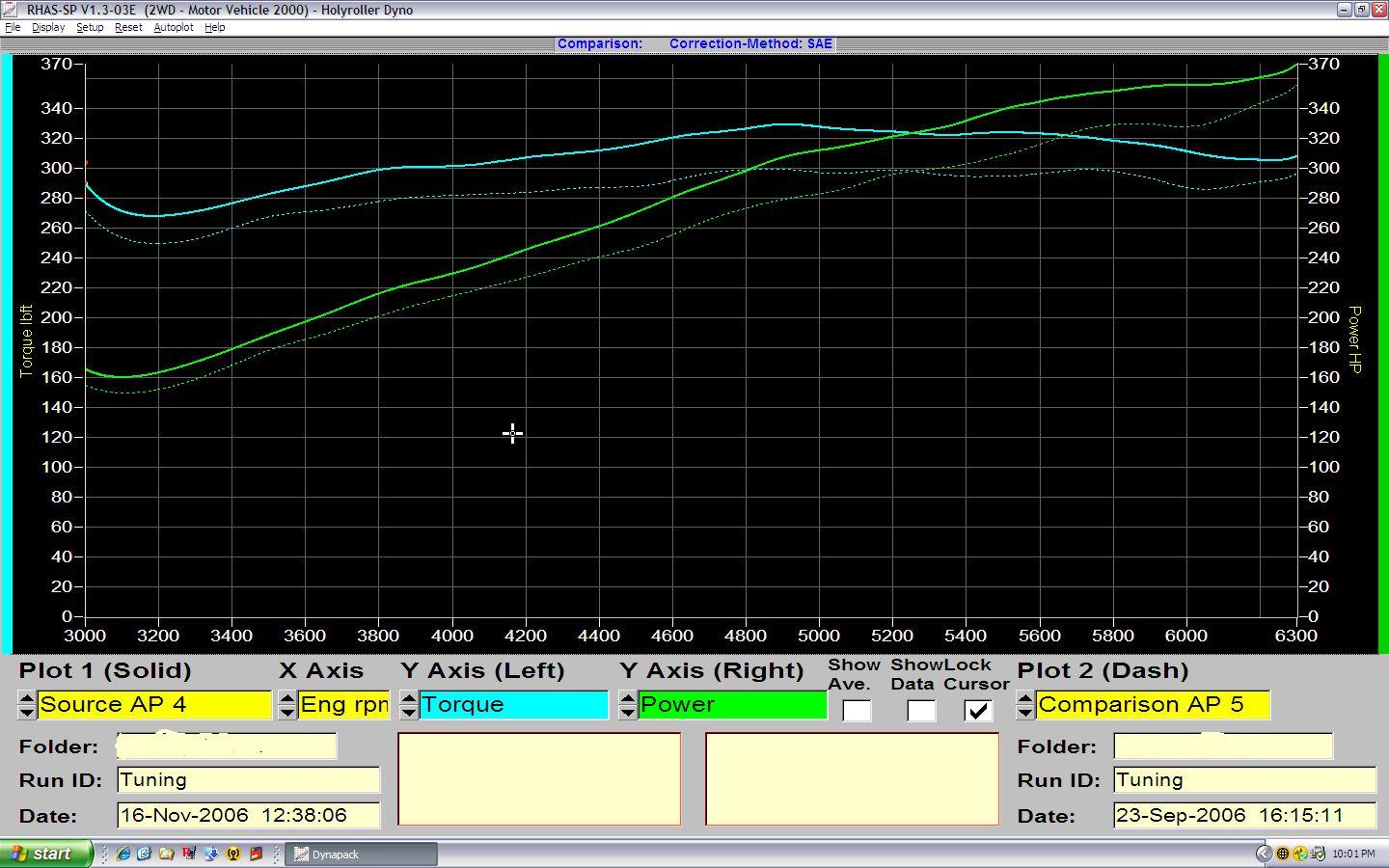

old Vortech dyno
