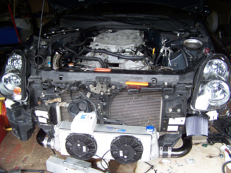

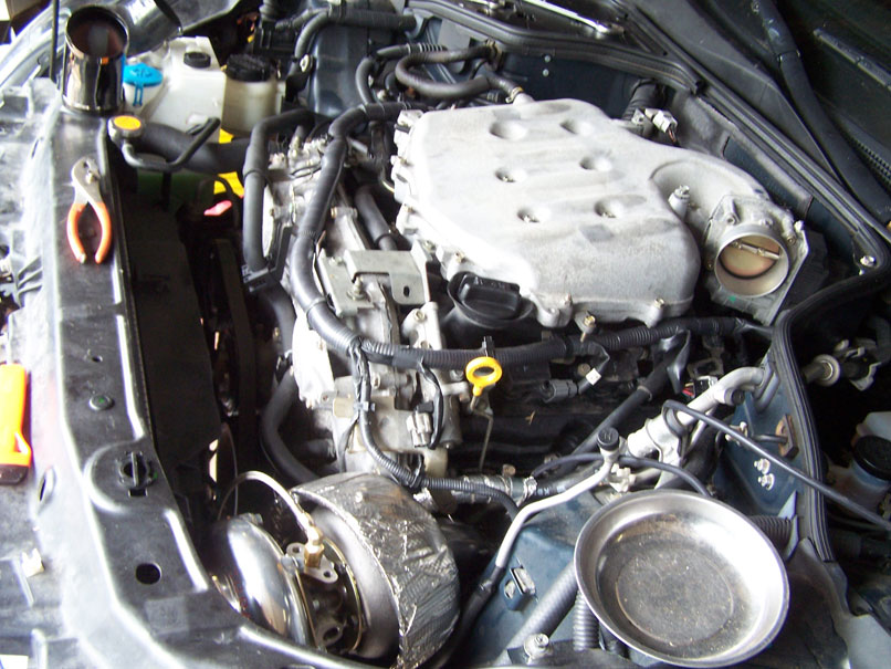

I took the Infiniti (2004 G35 SEDAN with Turbonetics single turbo kit) in to the Speed Shop today and made two dyno pulls. Two weeks ago I installed the Turbonetics 60-1 single turbo kit.

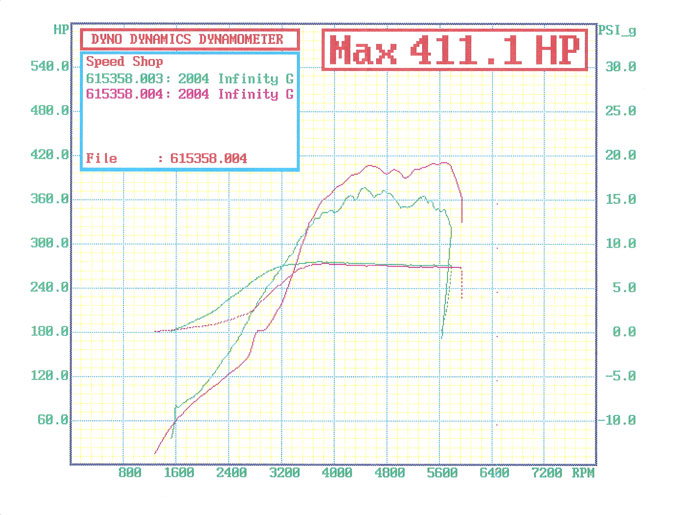

411RWHP, 460ft/lbs. Torque. AFR richer than 10:1 on 7.5psi.
408RWHP, ???ft/lbs. Torque. AFR richer than 10:1 on 7.5psi
It needs to be leaned out quite a bit, but otherwise I'm very happy with the results! I will get the torque graph Tuesday. I didn't realize that I left without it. (
I don't know if this site requires video or something to "prove the numbers", but I was only there to make sure the AFR was in a safe area so I didn't bother recording. This car is being used as my daily driver.
-Rich

Give me a sec. I'm trying to post the dyno sheet but I failed the first time... Heh.
Old Sep 1, 2007 | 11:42 AM
Supra's Avatar
Joined: Jul 2007
Posts: 17
Dyno sheet?
Old Sep 1, 2007 | 11:48 AM
Supra's Avatar
Joined: Jul 2007
Posts: 17
I thought this graph was HP/TQ but it's the two HP graphs (second pull was 408HP). Both torque and HP seemed high to me, but I asked the guy running the dyno and he said, that what the screen showed was accurate, and generally speaking what his dyno shows is consistent with track times and other dynos. He's located in Rockford IL and does a ton of business from Chicago and is very focused on high HP VW's. So he's not some fly by night outfit. <shrug>

Dyno sheet says "Dyno Dynamics"... He's had it for 2-3 years. It's a portable unit that you drive up onto, has rollers and such. They do a ton of events with it, in fact this weekend he's taking it up to Milwaukee WI for a bike event of some sort. He had packed the computer after my runs, which is why I have to wait until Tuesday to get the torque graph.
What a bitch. Well, even if the numbers are off, the car is running great! LOL
