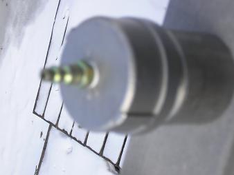

You dont need a Utec to get the power out of a stock Vortech SC . Both of the guys above arent making the normal power made by stock kits because they arent making full boost . And both need to be tuned right . 6 PSI isnt going to get it . They either have a serp belt slipping or a boost leak . Boost leaks are hard to find because they dont leak until you are in boost putting preasure on the system . Most boost leaks that cant be found are around the edges on a aftermarket plenum or plenum spacer . Adding one or two more gaskets and trq.ing the bolts at the right specs solve 99% of the leaks . I battled the same leak early on with my SC in 2004 . I could never find a leak and my belt was tight as hell , but still could only barely make 7psi at redline . I added two fresh plenum gaskets and that solved the problem . Ive come up with this pipe with a quick release air hose fitting on it . I hook this up to my IC pipe right before the BOV and then cap off the exhaust . I use my air compressor to preasurize the whole system to find any leaks
Attached Thumbnails Dissapointed with RWHP from Vortech Kit on '03 5AT-p2030017.jpg
