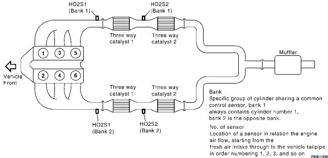

hey im gettin a bank 2 sensor 2 heater circut low code. I know its time to replace that 02 sensor. I know its the rear o2 in my test pipe but is bank 2 the passenger or drivers side? I pretty positive its the passenger side but i just wanted to double check. Also when you go to order them online it only says rear 02 right or left, so which veiw are they looking at it? for the drivers seat or from the front of the car head on?

They are sitting in the driver's seat. You want the one with the green plug.

already have that done this code has nothing to do with that though its just is a bad o2 when the heater circuit is low..^^ thanks for the pic
