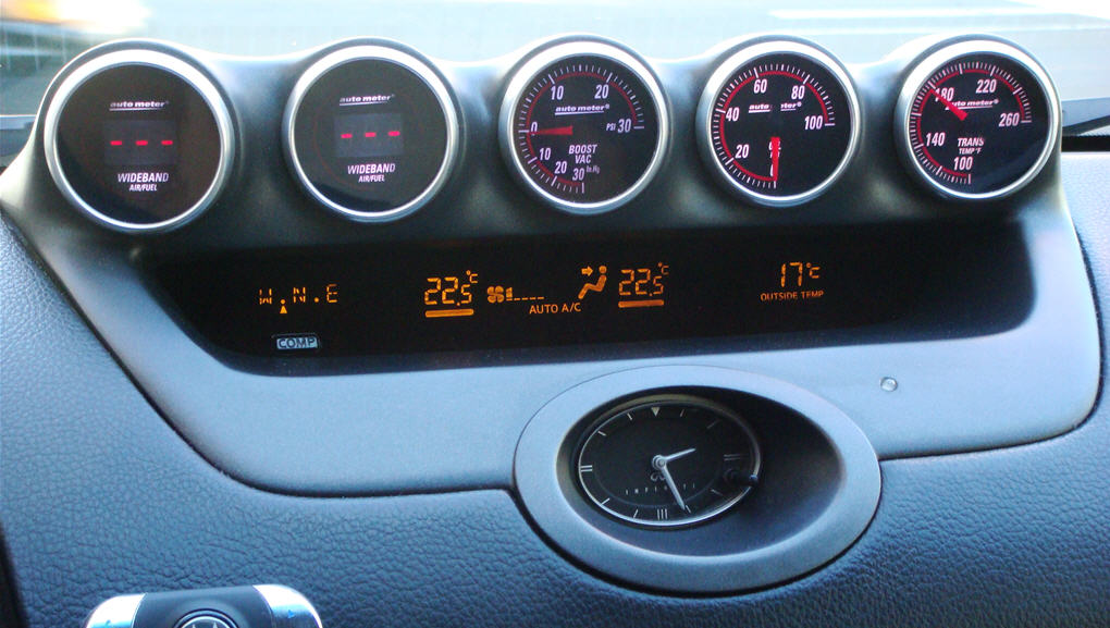

I went with A/F, Boost, Oil Pressure, Tranny Temp...
Where did you get that gauge pod? Or is it totally custom?
Old Dec 22, 2008 | 09:19 AM
jonnylaw's Avatar
Joined: Jun 2005
Posts: 1,498
From: Meifumado
^^that's gotta be custom. looks nice.
Old Dec 22, 2008 | 11:16 AM
sliderg35's Avatar
Posts: 1,282
From: Canada
Yes, totally custom. I think this is how Infiniti would have done it if they offered FI from the factory.
