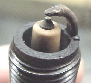

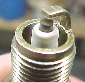

Pre-ignition
Pre-ignition is defined as a normal combustion process starting before the ignition spark is initiated. This is usually caused by a local hot spot raising the mixture temperature above its auto ignition point. As combustion has started before it was intended to, peak cylinder pressure occurs too early in the cycle. This leads to excessive pressures and temperatures, often while the piston is still in an upwards motion with cylinder volume decreasing rather than increasing. Pre-ignition effects can include piston and spark plug electrode damage. Pre-ignition is usually not audible and can often lead to detonation.
Effects of combined pre-ignition/ detonation event on piston dome
Plug suffering from mild pre-ignition damage left, normal plug right

Pre-ignition

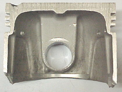

High silicon forged piston for use on naturally aspirated and low output turbocharging. Note relatively thin dome and corner radii.
Cast factory piston left, custom designed low silicon, forged piston right
Note thick corner radii for higher heat tranfer rates
