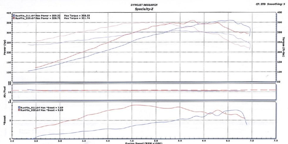

-faster build up of boost so much more midrange torque. though from my research this property does change slightly depending on which rotrex model you go with though since it'll shift the pressure ratio a bit.
-check the attached gragh courtesey of crtan77. this is comparing a vortech kit with the HKS kit that has GTS8550 which similar in design to the C38-81 (the one i have is the bigger one, c38-91).

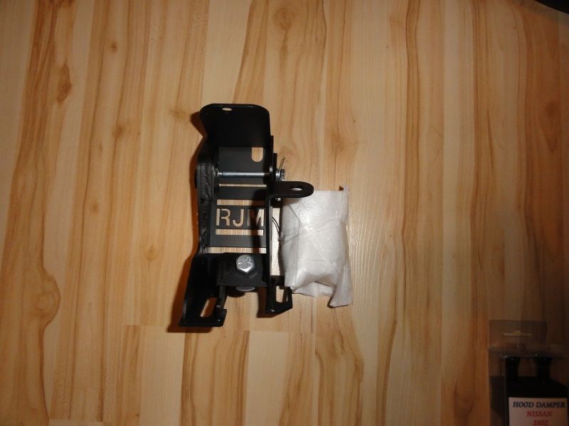

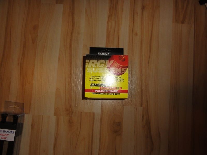

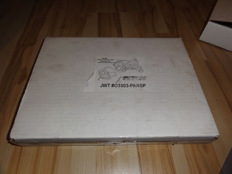

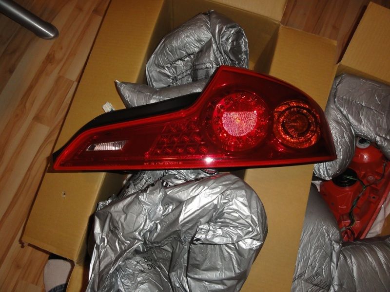

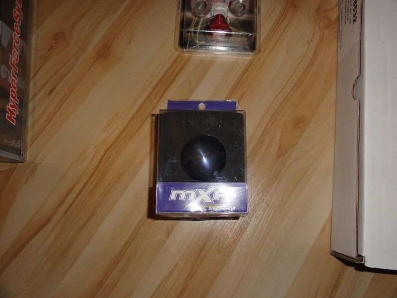

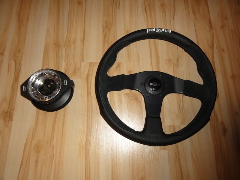

Not related to the SC but some parts I've amassed the passed few months.

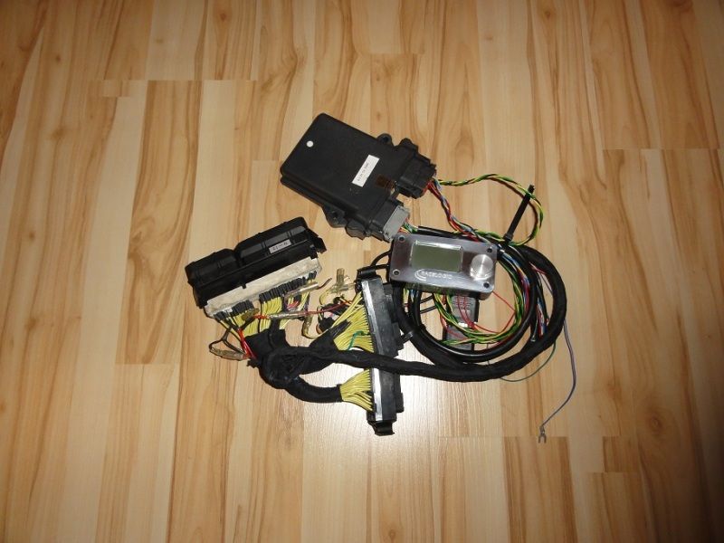

Racelogic Traction Control system
Personal Pole Position Steering wheel and Work Bells QRS hub
RJM adjustable pedal

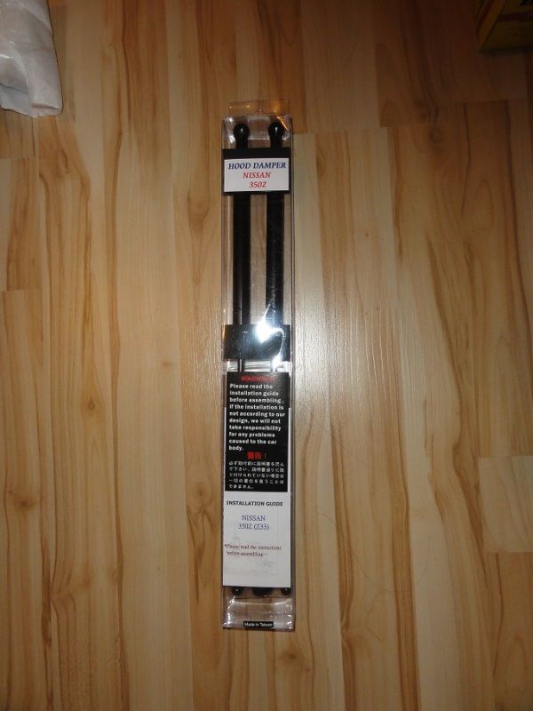

B2autodesigns hood struts
Energy rack and pinion bushing
MXP titanium shift ****

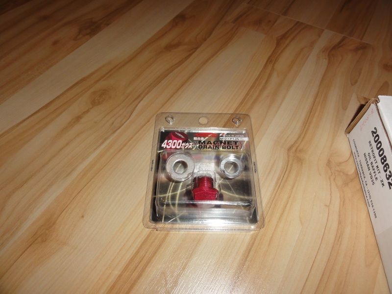

Project Kics magnetic oil drain plug

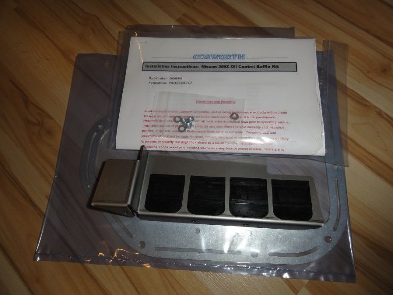

Cosworth oil control baffle with non-revup bracket
JWT oil pan spacer
JDM 06 taillights

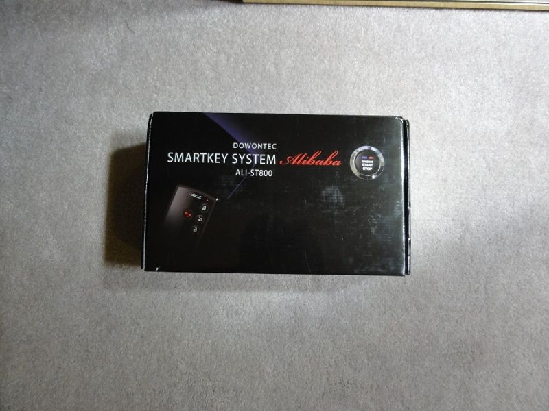

Auto Innovation ST800
Definitely interested in a review on this
Old Apr 7, 2012 | 01:30 PM
  #57
gabe3d's Avatar
Joined: Jan 2005
Posts: 976
Likes: 48
From: Bay Area, Ca
^ will do.
