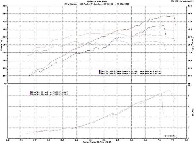

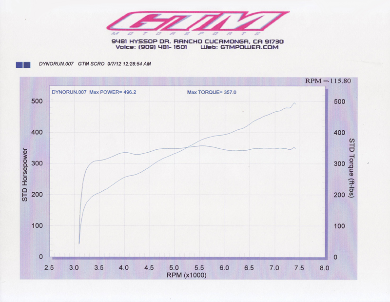

I'm liking how the power keeps climbing all the way to 7500 and the tq stays very flat.
Attached is the dyno graph from the run in the video. It's a very safe tune and the main focus for this was to break in the supercharger and get the car up and running stably. Once the final pulley goes on there a more in depth tune will be done to make sure we don't leave too much on the table.

Wow 496WHP on 9lbs is impressive.... i cant imagine a supercharged G with over 500WHP talk about instant neck snapping power.

That blower is rated 600hp and not whp.

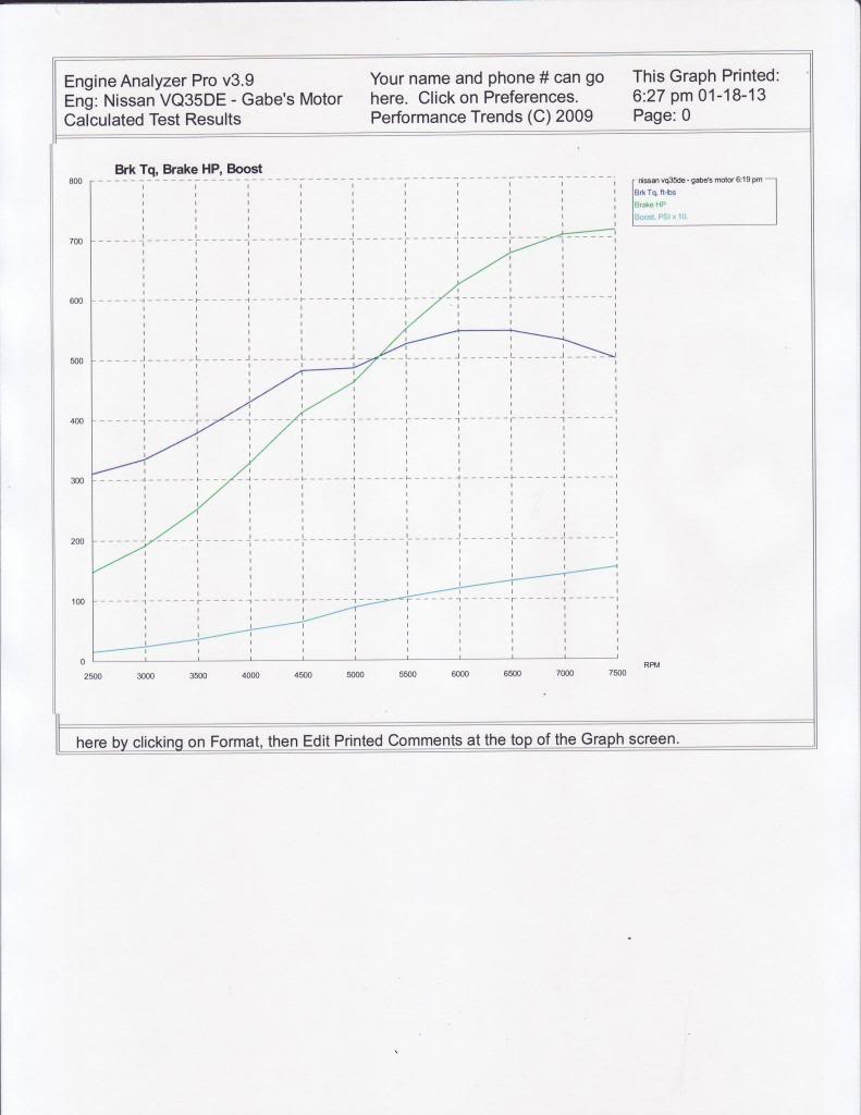

Some updates. Got this a while back and decided to put it up now. It's a simulation graph.

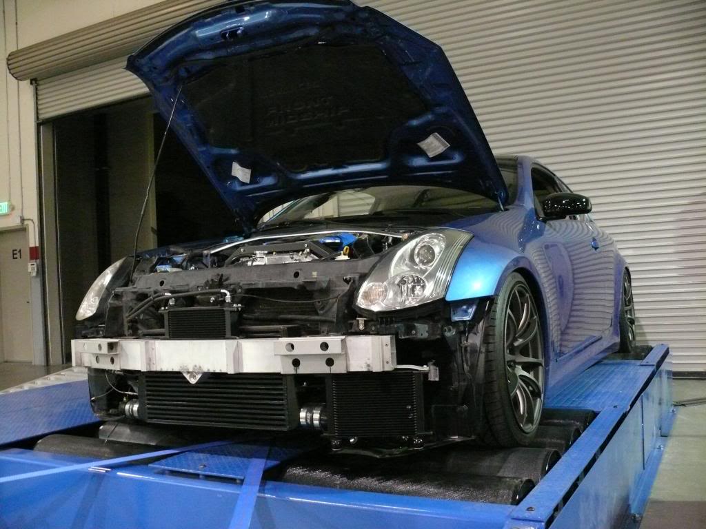

Car went on their new dyno but it was too low to do a full throttle run so maybe GTM will get some new baseline run for me later today, hopefully.

Knock sensors OFF vs ON

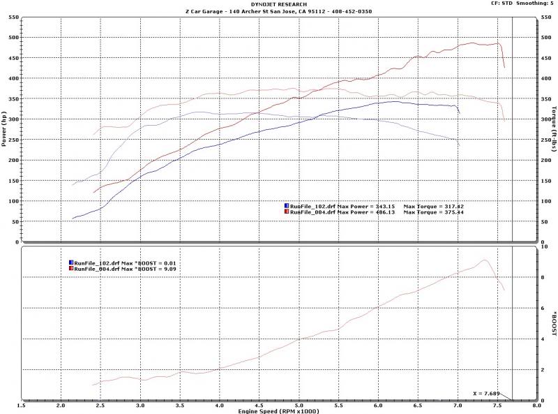

Knock sensors OFF vs NA setup

To understand the situation better some exchange with Sam initiated and as a result we will check a few more things down the line regarding the health of the longblock when I am away or when summer time is over, but for now I'll enjoy the car the way it is.
