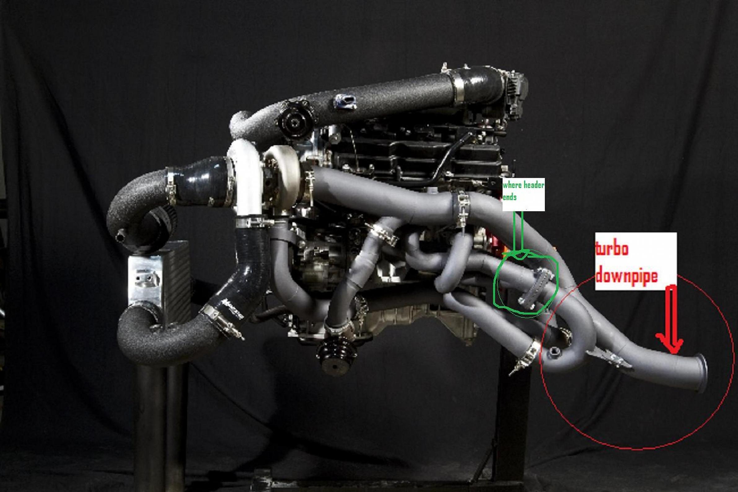

not to ruin your excitement but how does the dual header back exhaust connect to the single turbo downpipe? Both headers run into a collector that connects to the turbine housing so a header back exhaust system won't fit properly. Shouldn't you get the y-back type exhaust?
I dont think it's a true dual, look at their website
I was just trying to help. Didn't want a shop to take advantage as they are trying to clear out their inventory.
I did look and based on your description of "header back dual exhaust" that's what I looked for and as is that system would not match up. I'm not talking about it being "true dual or not" I'm talking about the connection points to the headers or turbo downpipe. Header back, similar to cat-back specifies where it connects...so the header back system would connect to the driver's and passenger's side headers...but the single turbo kits have crossover pipes that connect the headers to the turbo.
I ask you to verify and make sure. But if you don't see what I'm talking about then...oh well. As long as you get it worked out.
http://www.momentumperformance.com/p...5_Dual_Exhaust
That's the exhaust, I'm not very familiar with the technical aspects of it, can you tell from that if it's a problem?
I kinda see what you're saying though, it's like the exhaust has 2 connection points at the engine, but with the turbo it looks like there is only 1 outlet, so there might be a piece in the exhaust that I don't need?
If you look at the ends where they curve up to the engine...that is where the issue is. There are 2 pipes going up that would go directly to the headers, factory or aftermarket.
However, if you look at a pic of the kit assembled on the motor you will see there is only one exhaust outlet now...the downpipe coming from the turbo.
Look at this pic. Hope this helps. In terms of the knock off turbo i'm not sure how to check. There was some thread on my350z. I didn't mean to scare you. The shop should do you right. If you get the turbo you may be able to call garrett with the numbers on the box to verify.
Attachment 147989
You're good, but yeah I was looking at that pic and figured out what you were saying, I'm not sure if I need that particular exhaust. It's strange that Momentum would sell it and suggest it's great for turbo cars but design it like that, but I get it now. I'll ask the people at the shop about it. Thanks for your help!
