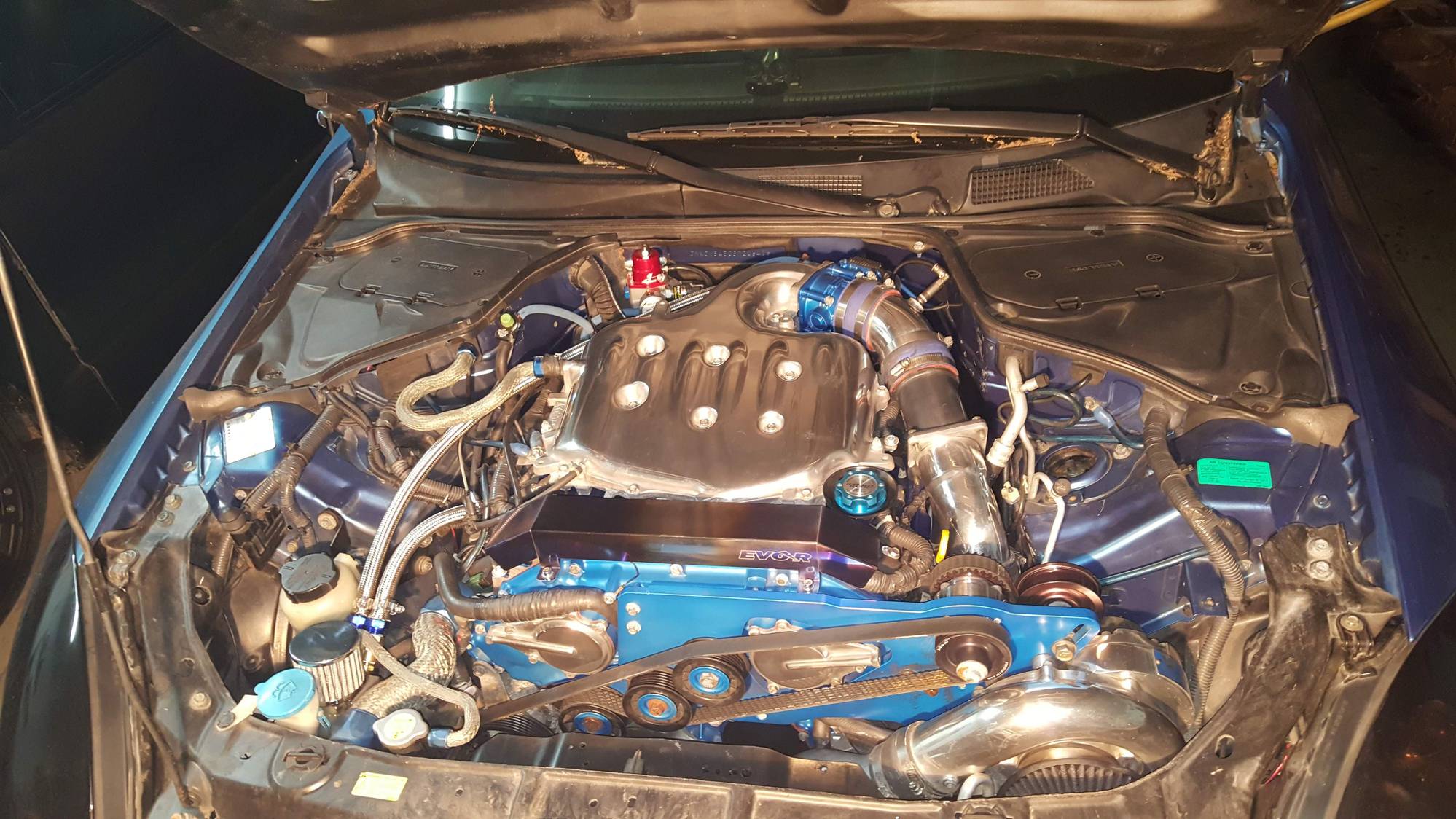

Looking to upgrade my intercooler...here are some of my performance mods..
Stage 3 BC Cams
ARP Head and Main Studs
BC Rods
.30 over JE Pistons
Vortech Supercharger
Vortech Supercharger Upgrade
Vortech 2.87 Pulley
ProEFI EMS
Snow Performance Methanol 75hp (Kicks in at 4psi boost)
ID 1050x Fuel Injectors
AAM Fuel Rails / Return System
Momentum Headers
Fluid Dampr Harmonic Balancer
Aeromotive Fuel Pressure Regulator
NOS Nitrous Intercooler sprayer
Aeromotove Fuel Pump
CJM Return Fuel Correction Kit
Injen True Dual Racetech Exhaust
I was last dyno'ed at 512hp and 480trq before the sc upgrade, methanol, sprayer and a few other little things so I'm not sure what I am at now BUT the shop said if I change the pulley and the intercooler I should be able to hit around 800hp. Might be a bit steep but I realized I am still running the Precision intercooler that is only rated at 350hp lol..so I am trying to research a good intercooler without going too big and killing my power instead.
Does anyone have any recommendations? Or even advice?
Thanks!
