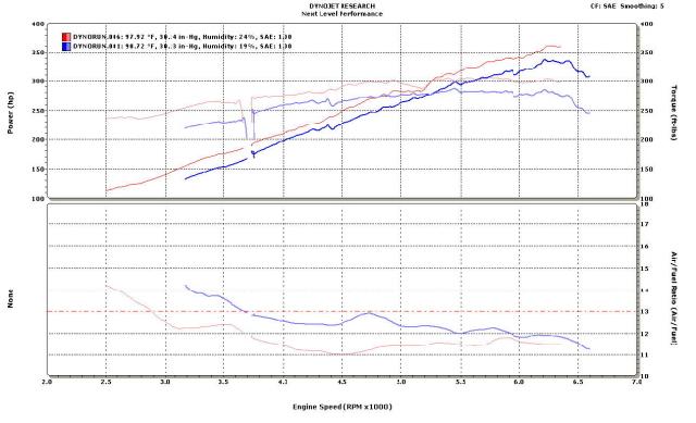

The headers will give you more horsepower (20 or so), more torque (20+ at the wheels) and less boost! The car will be able to breath much more easily with the headers and this equates to more power.
I overlaid a dyno of mine and jasons. I have the Crawford Plenum, Crawford Headers, Crawford h/f cats and JIC Y-Pipe while Jason only has the Crawford Cats.
This was our dyno comparison (both of us had slightly loose belts)... Notice how I had a lower A/F (this equates to a 'safer' tune and less hp/tq than if I had it leaned out some).

Neff, I wouldn't put any stock into that dyno day. We had loose belts, dyno jet was funked up and that a/f sniffer was waaaaay off. No way am I running 13s a/f. I've datalogged a bunch and never got that high.
With that said...would you recommend 20+ hp/tq for $1500 (conservative number)?

Neff - with the vortech and complete crawford, you are getting 388whp? I thought you could get around 380whp stock, with nothing else.
