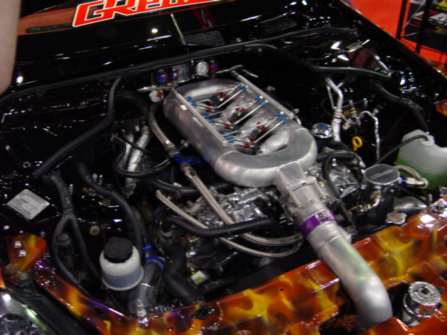

They were able to do it on this one. I love this IM!!
Yes this is true but it has a different hood.With our plenum you can keep your stock hood.

From: Sac town
It has the TS hood.
