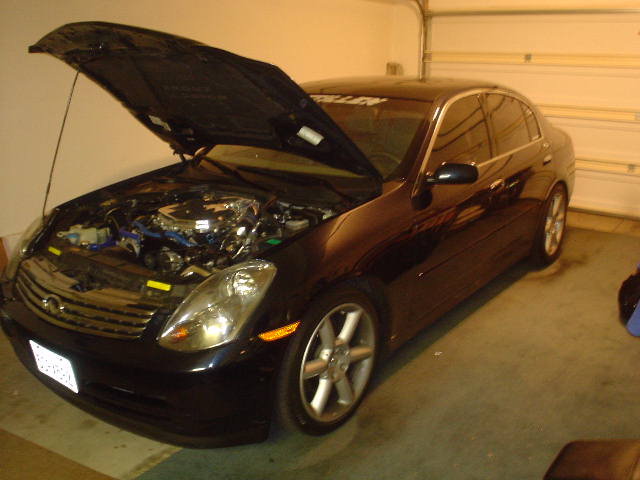

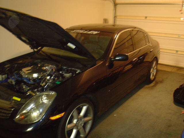

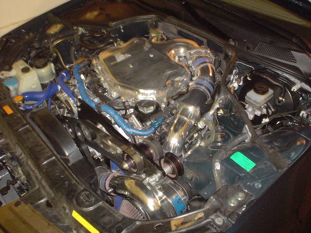

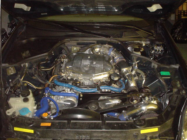

Hey Guys,
I have a G35 Sedan with a vortech kit on it. The kit has been on the car about a year, with 20,000 on it. Since I have bought the car I put full synthetic oil in it every oil change. Recently I notice the oil level drops quickly and I have to add a quart every 600 miles to top it off. Overall the car runs great and I have had it tuned by Churches Automotive in pasadena. I tell him to set the Fuel/Air mixture on the rich side to be safe, because I am running 10psi on stock internals.
Do any of you guys have an explanation to why I am burning oil like that?
Also I have no cats on the car, stillen race pipes, stillen headers, and 3 inch piping. When I push the gas a lot on the street a puff of black smoke comes from the exhaust.
Explanation or advice please......

Since the vortech uses oil for lube. It might be possible the vortech's seal might be bad. That's my guess.

You might want to run a compression test. The oil could be blowing by the piston rings.

+1 rings and ringlands might be done
