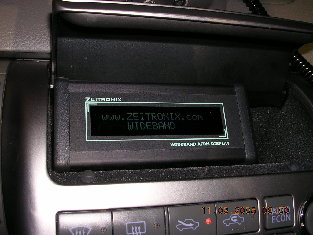

Cool
I'm very happy with my Zeitronix.....
