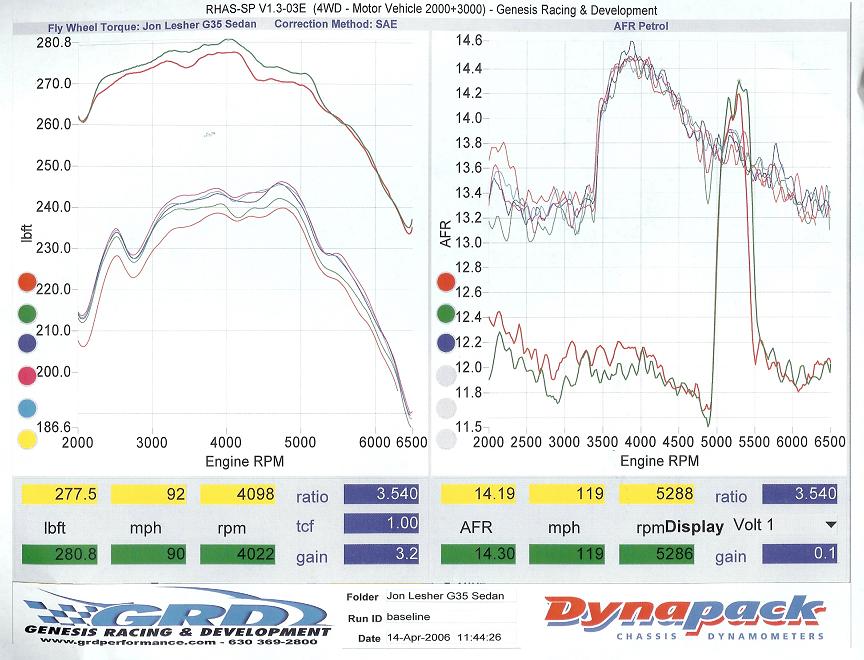

Hey guys, I have the Stage II put on my car and GRD and Stillen are trying to figure out what is wrong with my A/F ratio's. Can anyone here give me insight to bring the A/F ratio down? Here is the chart.
The ones that start in the 12's are the SC and the ones that start in the 13's are stock with Stillen TD exhaust. Stillen is trying to say that my stock A/F ratios are messed up as well. Can anyone post theirs so that I can have something to compare to?
BTW, if it matters, these A/F ratios are measured via the exhaust. GRD says that they read a little higher because of the cats doing their job. Is that true?
Also, there is no sign of detonation, not that I can hear anyways.

based on the extensive dyno tuning that Stillen did on my car when trouble shooting my AF ratios, I can say your Stillen AF ratioslook pretty good. Sam stated 12.2:1 was best on the Stillen setup, we just couldn;t get there with the stock fuel pump

But what about the spike into the 14's?
