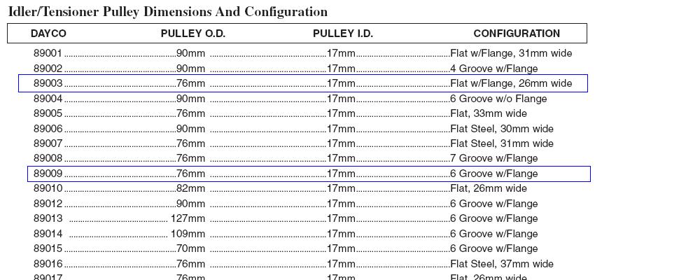

Part #'s for the grooved idler pullies? I'm going to replace mine.

Part # 89003 I confirmed works and I've replaced it a couple weeks ago. Judging by the Dayco info sheet and pics I'm going to assume the ribbed one I'm looking for (heh ribbed..) is # 89009
