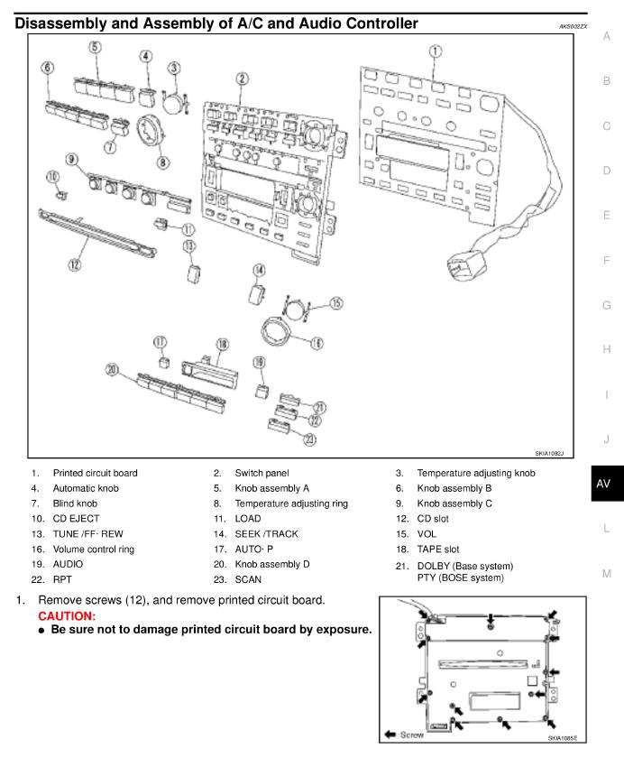

Okay, I've been doing some reading on this and it does seem that it is a board behind the finish panel. I am attaching a pic to see if I can confirm with someone that I am on the right trail. I think it should be number 1 in the diagram.
Anyone who has replaced this: How hard is it to get to and is this part available from any place other than dealer?
I can't believe Infiniti hasn't recalled this as many problems as it has caused.

im pretty sure the dealer is the only place... and i doubt it will come in that one piece... you will need to buy all of it as one...
look on eBay for used radios but then you cant be sure about those because they could be selling them for the same reason
