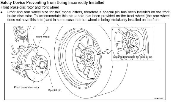

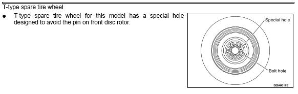

The OEM spare has a hole in the rim for the pin/bolt that's on the front rotors. If you don't get an OEM coupe spare, then make sure you remove the pin/bolt.
Attached Thumbnails Spare Tire for 2005 g35c with 19" stock rays-spare.jpg   Spare Tire for 2005 g35c with 19" stock rays-pin.jpg
