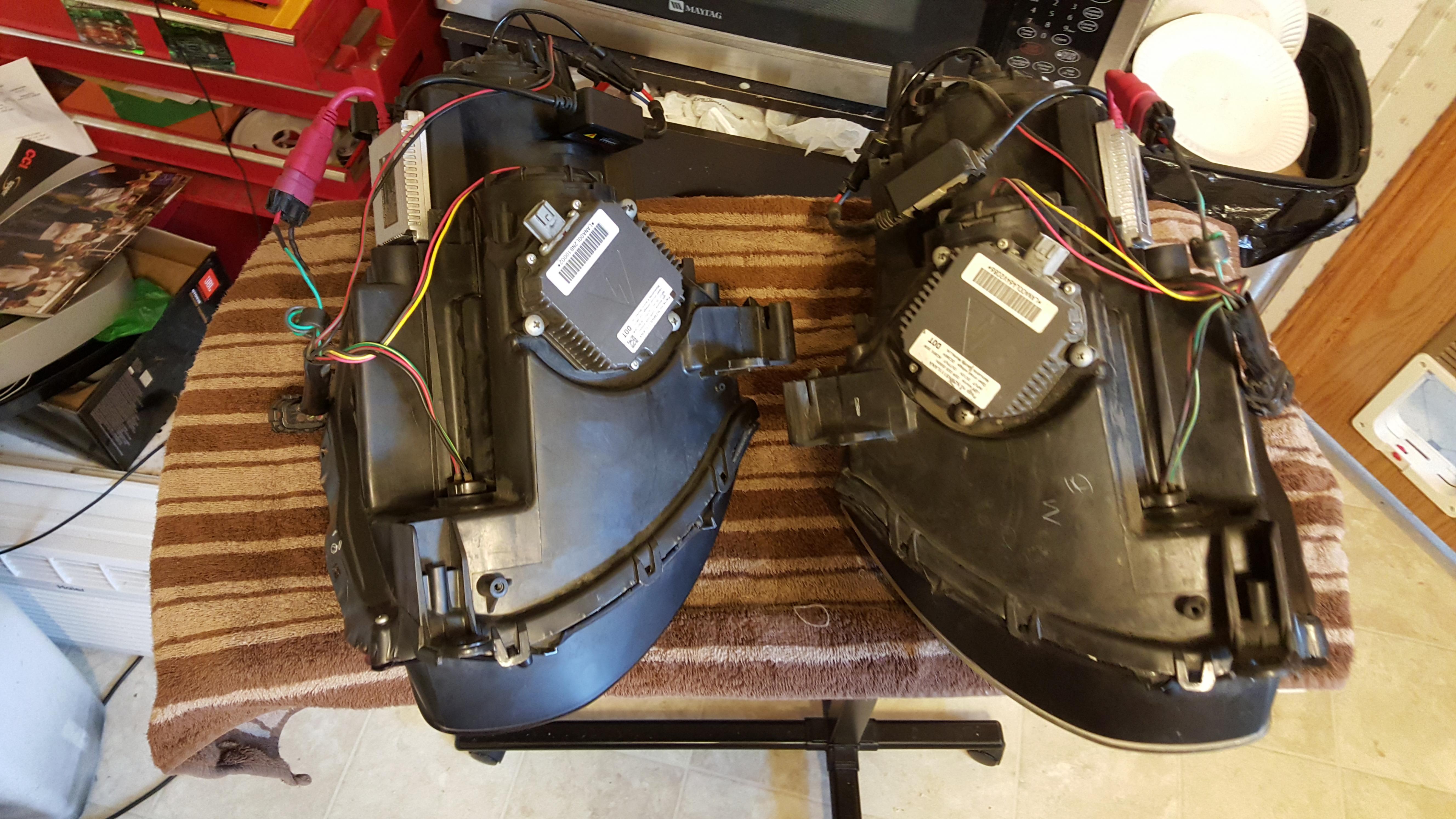

Nice, thanks! I'm still debating wether to use 3k or 5k when I install then in the fogs.

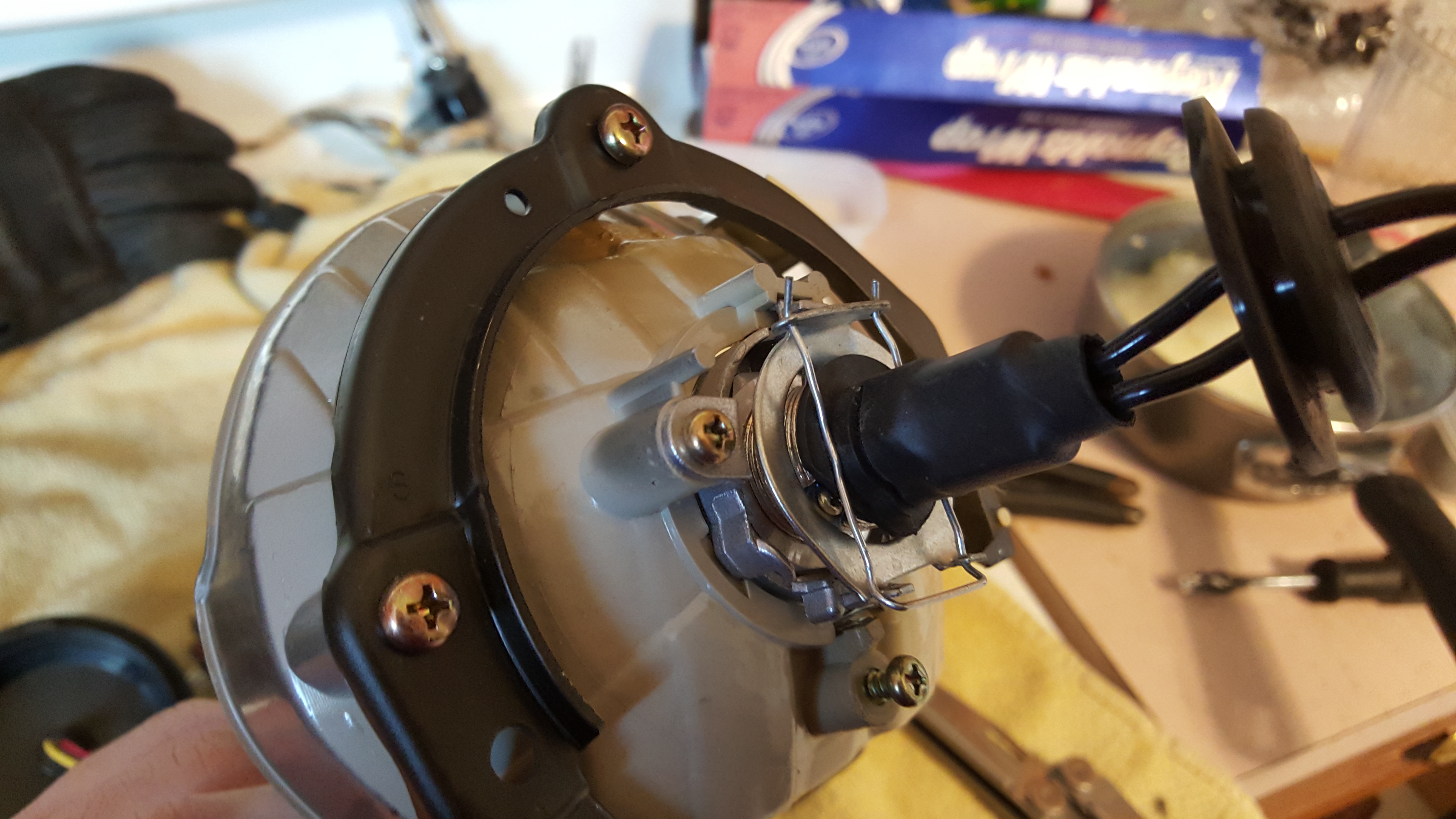

Heres how i mounted everything. Headlight housing suck, but didnt have to pay for anything since it was sitting in my closet lol

Left the oem ballasts in to keep it sealed. Cut off the hid harness plug and soldered in an h1 plug for new ballasts. Screwed ballasts on the backside of housing, and cut the high beam wire off of h4 bulb and soldered that to projector flap, so now i have bixenon projectors.
The projectors mounted through the oem hid mount pretty well, but getting the reflector shield over the big shrouds was a bit of a challenge when i glued the lense back on.
I havnt even adjust them and i can tell output is way better than my reflector hids.

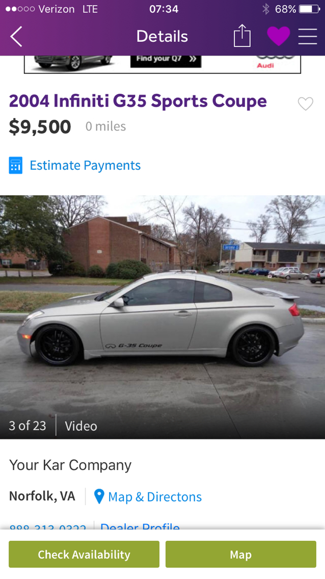

Wtf are these people smoking
18k and 110k miles
Ok.mp3

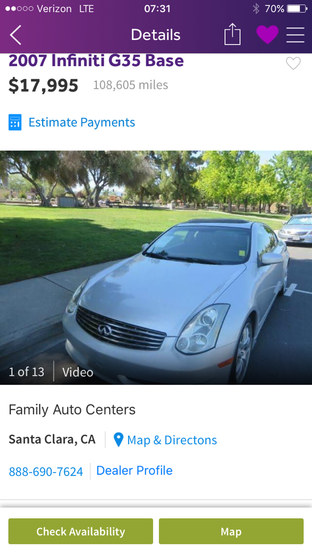

And on the other end of the ridiculous spectrum

That 04 is about right for the OTHER side of the country lol
no joke lol. dudes over here have to act all billy badazz
