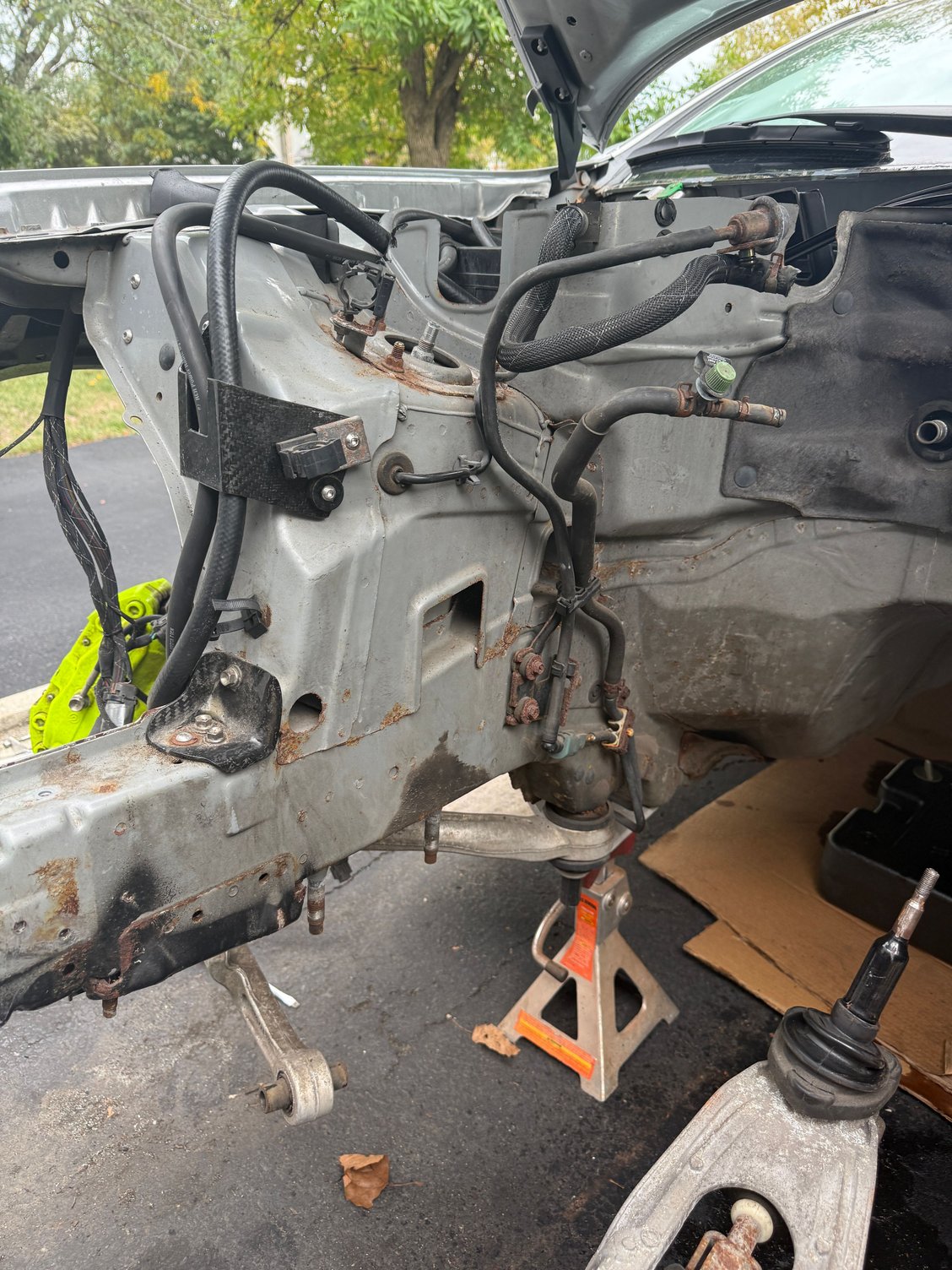

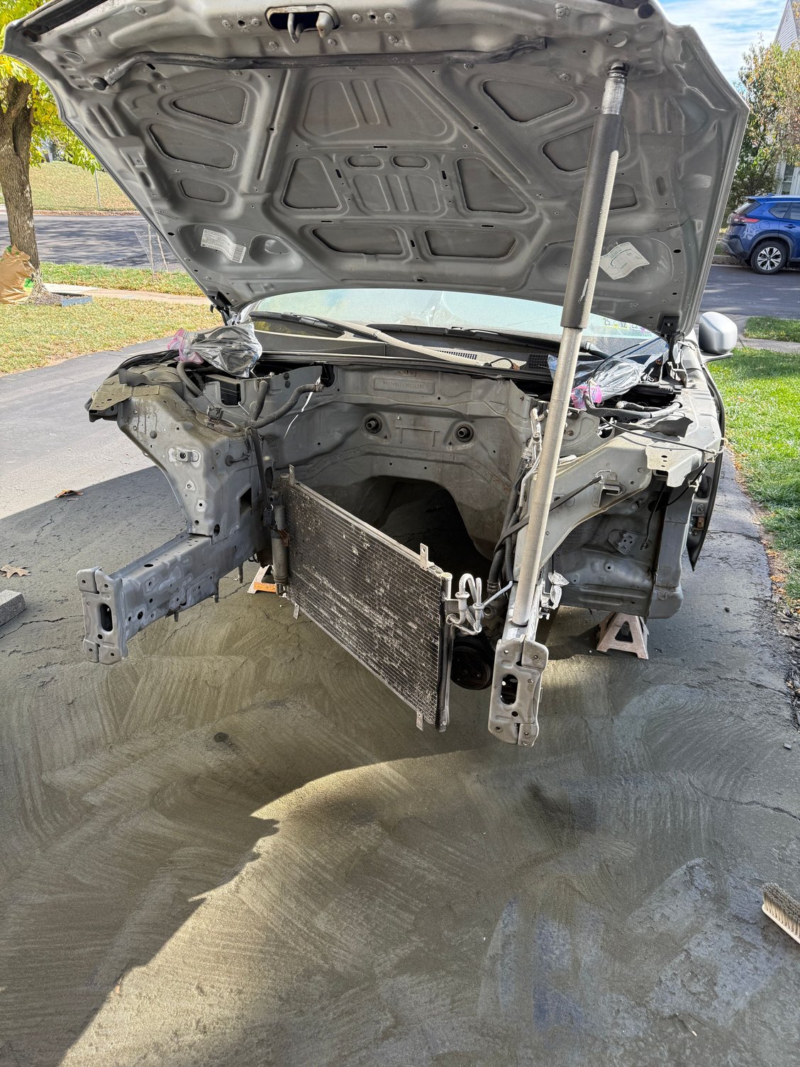

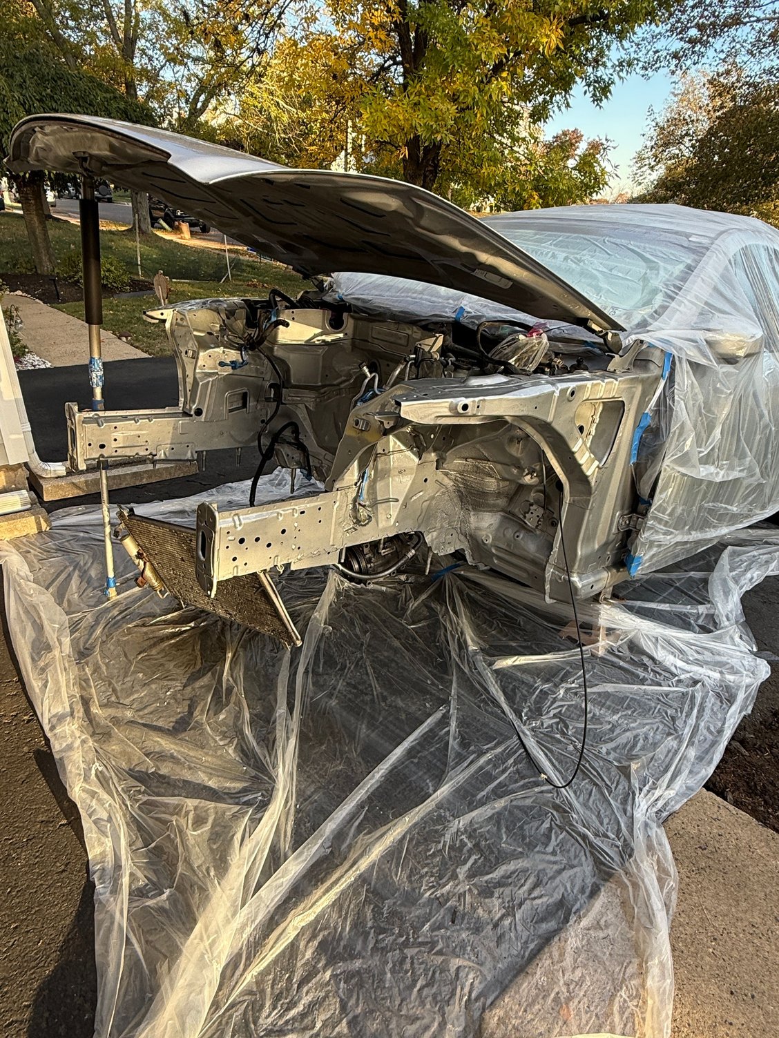

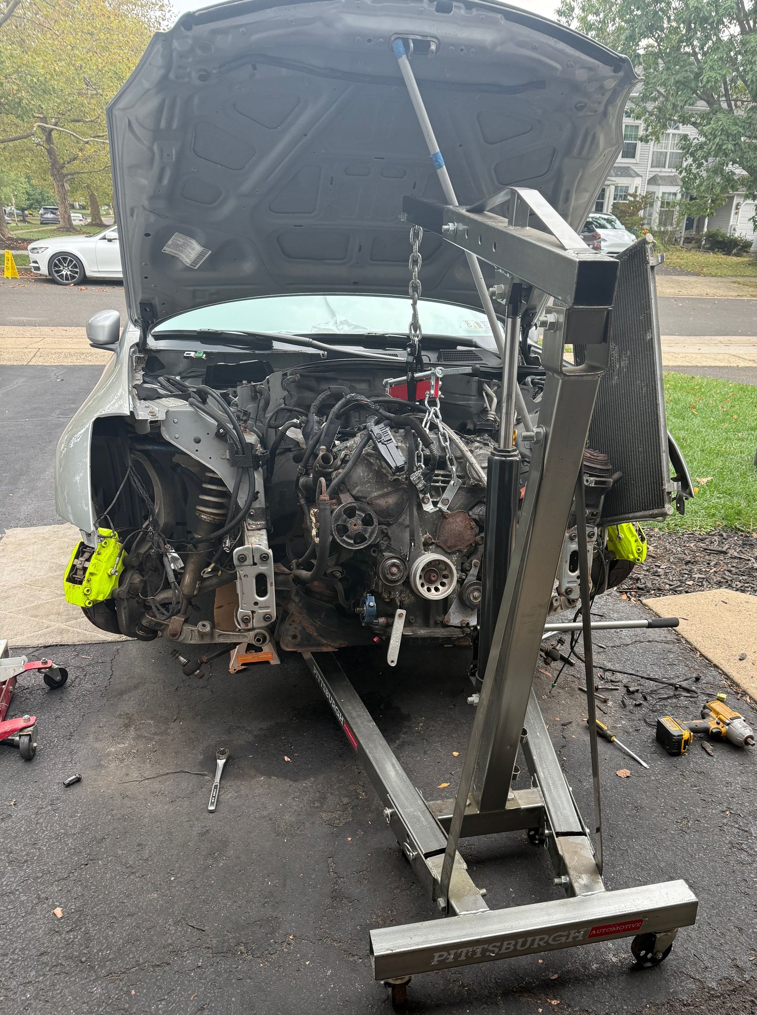

It's been a while since anyone posted here, so I'll give it a bump.
I ripped out my blown motor, sandblasted the engine bay, acid etched it, then sealed it with POR15. Preparing for an engine swap. Thankfully Sikky has some black friday deals.
engine bay was in terrible condition due to surface rust. I needed to at minimum sandblast everything, reseal, and repaint. For now that's the way to go. Long term a few years down the line I may need to get into the panels, but for now this is the path of least resistance:
Sandblasting:
Acid etched and resealed with a spray of POR15:

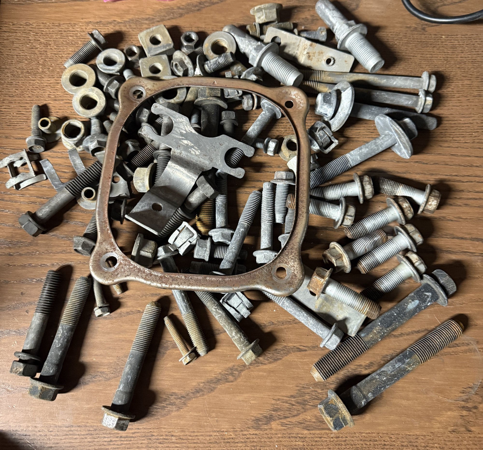

$500 and 2 weeks later I have a all my critical front end hardware back and zinc plated.
After stripping the rust with ultrasonic acid bath:
After Zinc plating:
