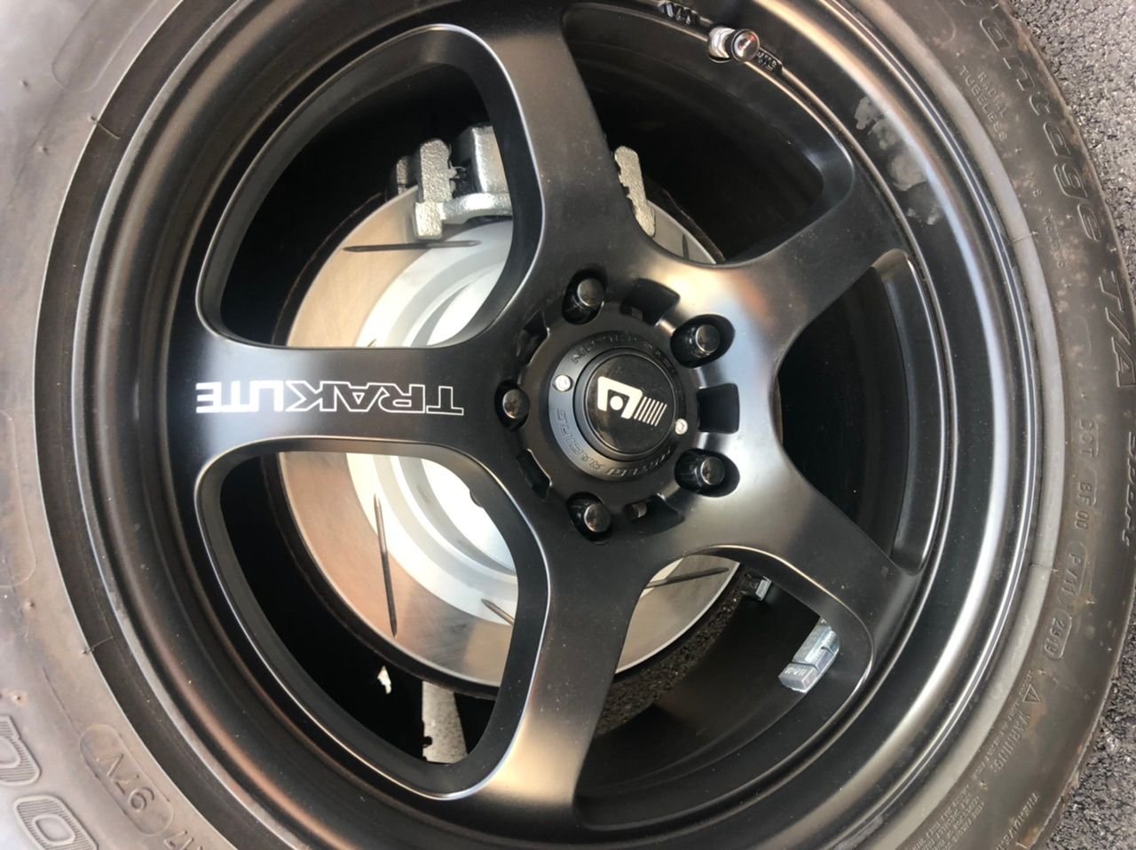

New all inclusive brakes and wheels. Rotors and pads from R1 Concepts, front Stop Tech calipers, rear Amazon calipers, rear only SS brake lines from Z1. New wheels from Tire Rack

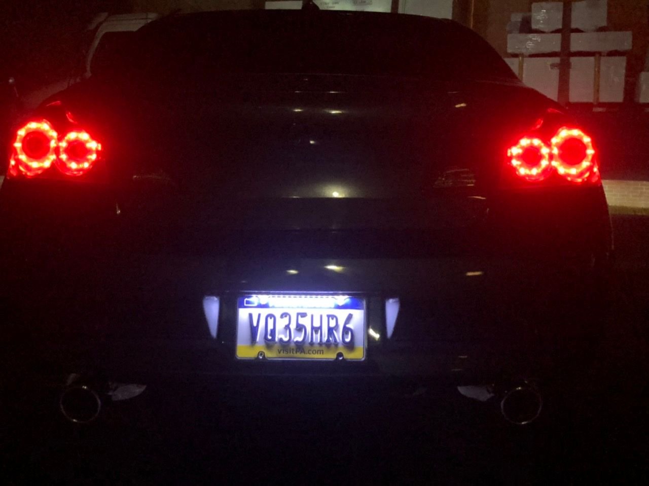

Bought a wired/lighted license plate frame due to the common bracket failure from rust on these cars.
