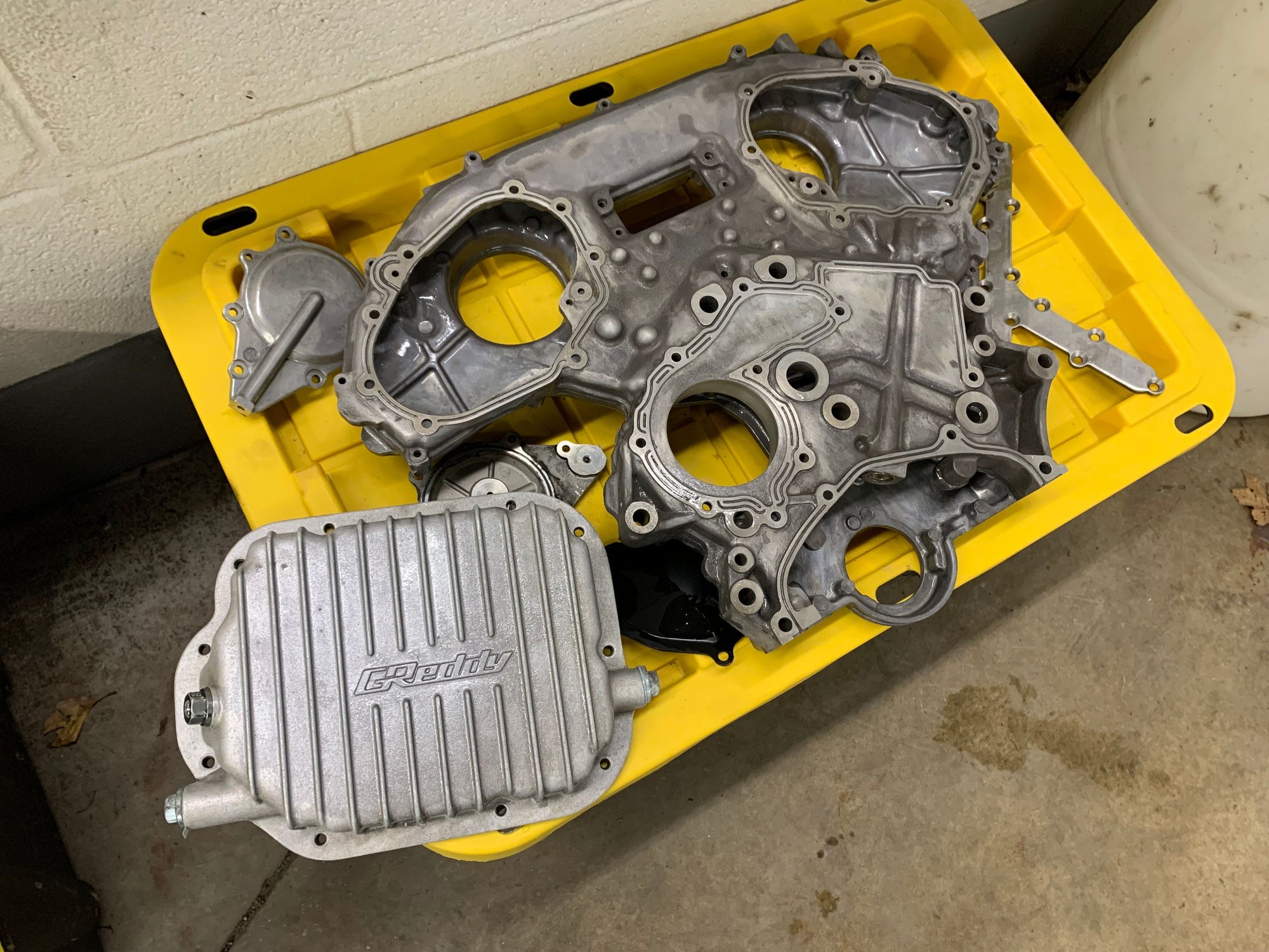

Yep, just a stock block type rebuild. Clean parts, new bearings, valve seats, valve covers, and reinstall in 80k mile chassis 😁. Car has been sitting months with no work.
i Considered a low compression build but Z1 among others does not recommend it for what Vortech can put out, and I don’t want to shell out the dollars for a turbo build when I already have the Vortech. It’ll never be fast as the bikes we have so meh. The noise and reliable power is enough for me.

stuff cleans up nicely with some warm water and acid… lol. Went from black to slightly corroded aluminum again 😅. Didn’t know the lower oil pan was silver! Spent over 2 hours scraping factory grey RTV 😭. Much more to go on the block and the heads!

Use a brass wire brush wheel on a drill to remove that RTV. It's SOOOOO much quicker, literally takes minutes. Brass won't damage the aluminum unless you're trying to damage it.
Just be sure to verify the wire wheel is rated for high rpm if you chuck it up to a die grinder, I've kaboomed them before and it's not pretty. Always wear eye protection with those things.
brass wheel took off way too much material, so I’ll be hand scraping for the rest 😅 of the aluminum.

Weird, I usually don't have a problem with them. What were you using, a drill, dremel, or die grinder?

Dremel, probably could switch to drill. Die grinder too Aggro.

Yeah it sort of depends on the base material, if it's steel then go full die grinder because it's FAST. Dremel is next most aggressive, drill motors typically spin 2k max so that is the least aggressive option.
