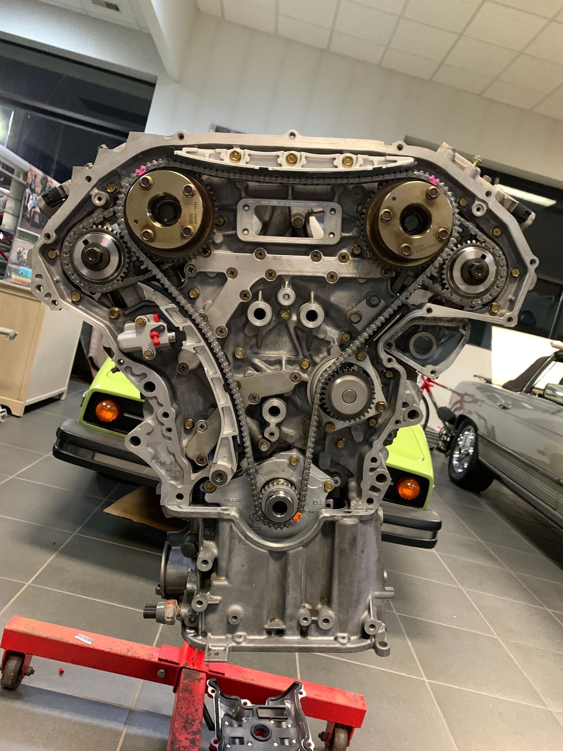

Put the rear timing cover on. Nissan makes it a game to put on the rtv. One step closer to completion.

Timing done, now to just put on the front crank seal into the front cover and put on a huge amount of black RTV on the cover and smoosh it together. I’ll be able to bring it home soon .
I also need to install the oil pickup tube and the lower pan, which also will need black RTV. Ill do both at the same time.
New parts arrived yesterday, unfortunately…
My Spec clutch disc that I was sending in for a re-pad was lost by UPS en route. I was going to get it repadded, for under $100 so I was super disappointed. Spec offered me a discount on a new disc, so I ended up choosing the “stage 3+ disc” from their options that’s supposed to hold up to 500 crank hp and theoretically have much easier modulation.
it Really blows when you were budgeting for a refurb and have to spend new clutch money 🥲. No surprise, this rebuild is more expensive than I originally planned. Bad luck there I suppose.
I’m just excited to drive the dang thing soon!

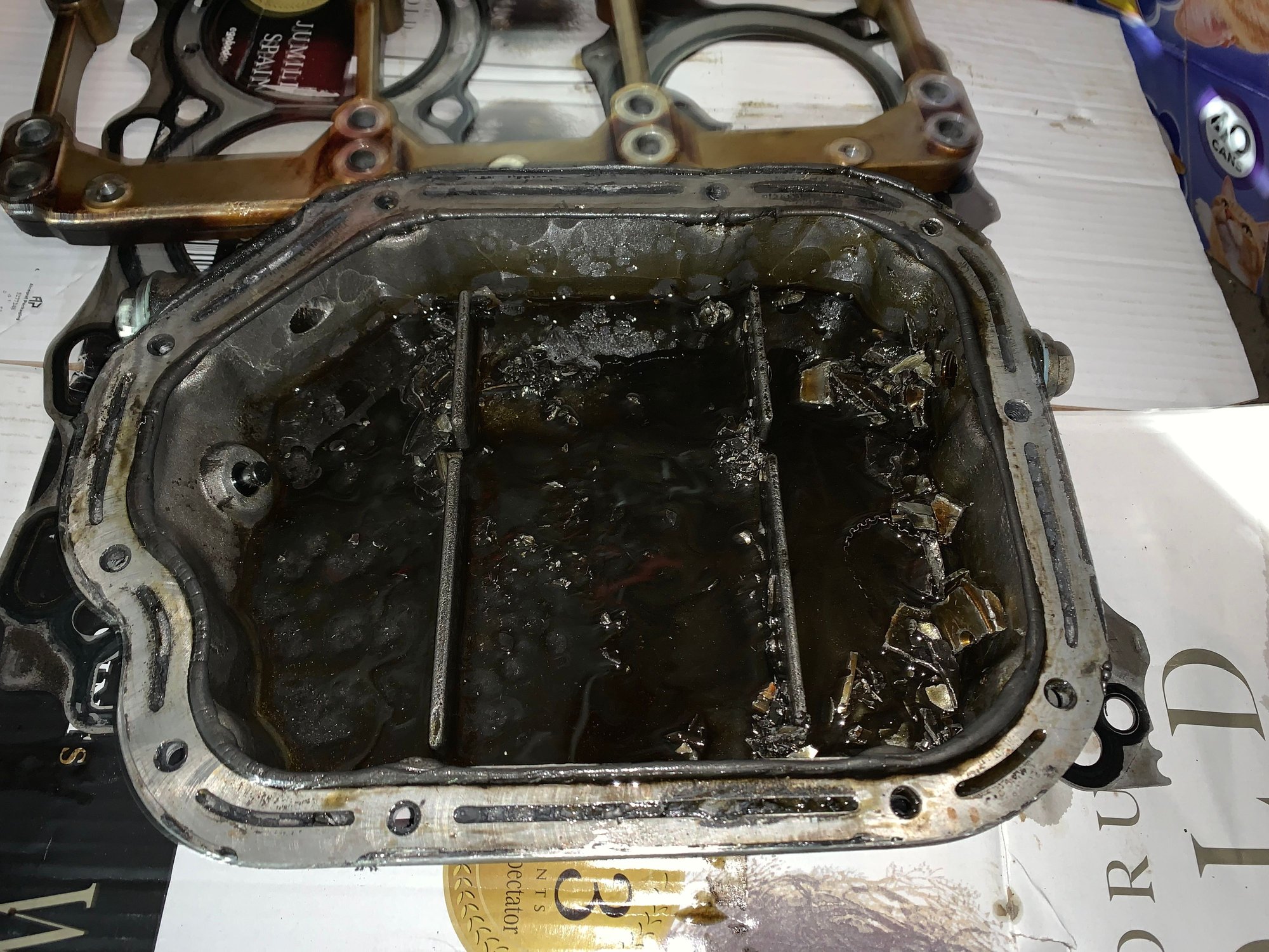

You putting an oil pan spacer on it?
just using the greddy flat baffled pan. pic before cleaned out and degreased lol.

Lol, KABOOM!
