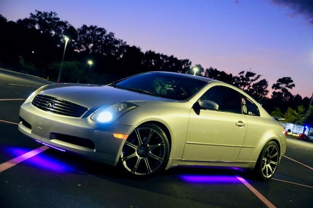

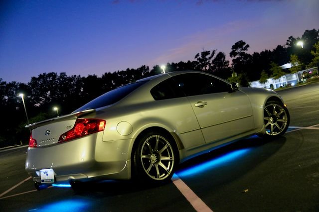

decided to bring my camera out for some pics

Looks nice man!!!

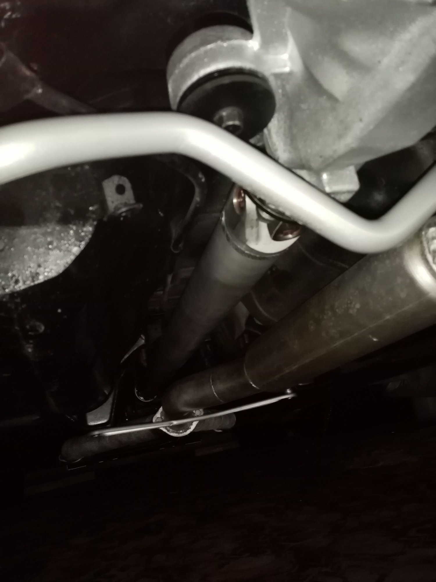

03 g35 Mt coupe. Stage 4 stillen roots supercharger.
I tested the burn out switch and one piece drive shaft that I fitted yesterday and drained gearbox oil and will leave it to drain overnight so I have something to do tomorrow too.
Burn out switch worked well but lit up the slip/abs light when used but resets when I turn the car off.
Dss drive shaft is similar to a lightweight flywheel in feeling and combined with a gktech diff brace- nolathane diff bush kit and z1 solid trans mount its a hole lot different to stock.

Thanks for the info. I've been researching the DSS driveshaft lately and will probably be picking one up.
Notice any vibrations or sounds with it at low or high speeds?

120ish mph and it vibrates a little, normal highway speeds nothing whatsoever.

I found it smoother than stock at lower speeds but nowhere to do 120mph for me. What I found interesting was undoing the standard shaft bolts it took a fair bit of effort to turn but the one piece almost had no drag at all. I would check your diff bushing before installing because with no centre articulation the stiffer the diff the better. Adding a diff brace will help support things too.
